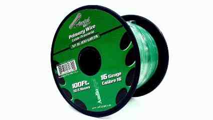

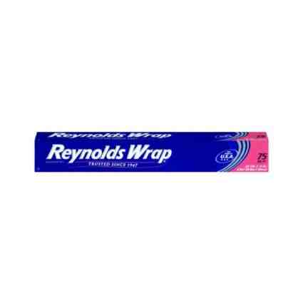

Here is another cheap way to eliminate the noise from your RCA cables.
For MID-FI people,
Wrap your cables with aluminum foil like this and you done.
For HI-FI people,
Wrap your cables with aluminum foil and connect all your cables to the cold pipe line in your house.(green grounding cable is recommended) :green:
For HI-FI+ people,
Your dealer knows the best for you and It will always sound better.  :thumb:
