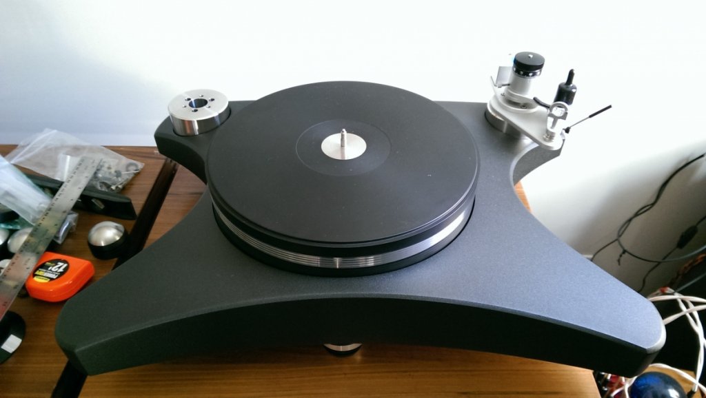

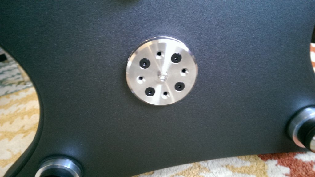

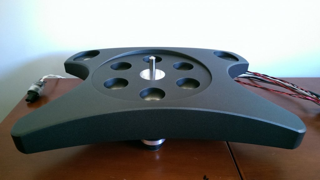

Plinth from a 3.5 x 26 x 18 inch chuck of Aluminum
Bearing housing for VPI HRX Super Platter Bearing

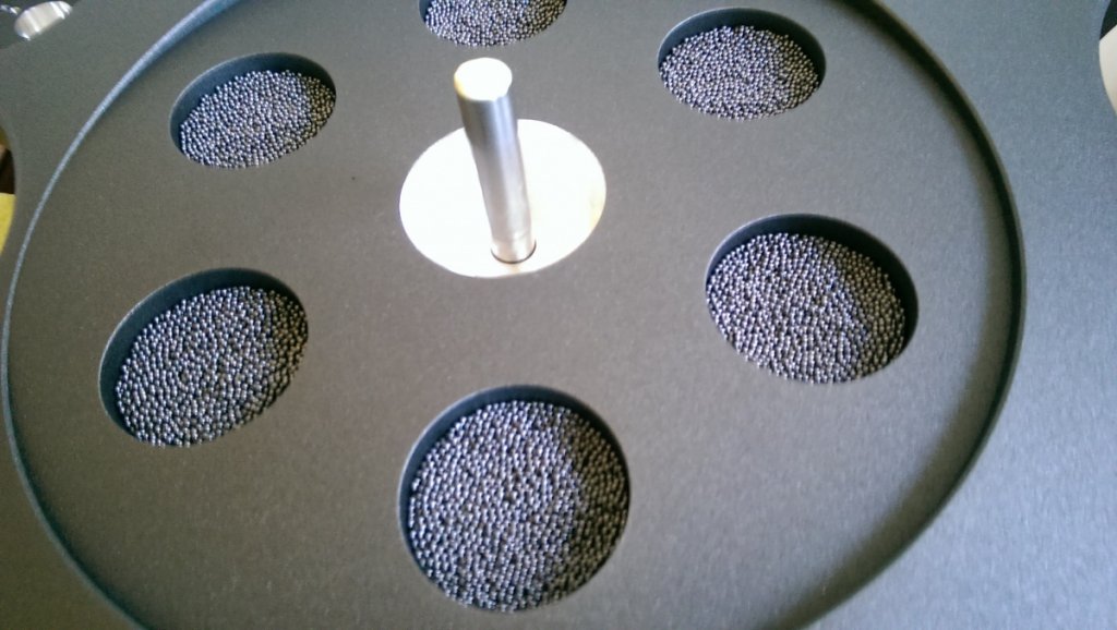

Lead shot filled plinth under the platter and surrounding the bearing housing
Awaiting the platter, arm mount pods and arms
Arm mounts on....

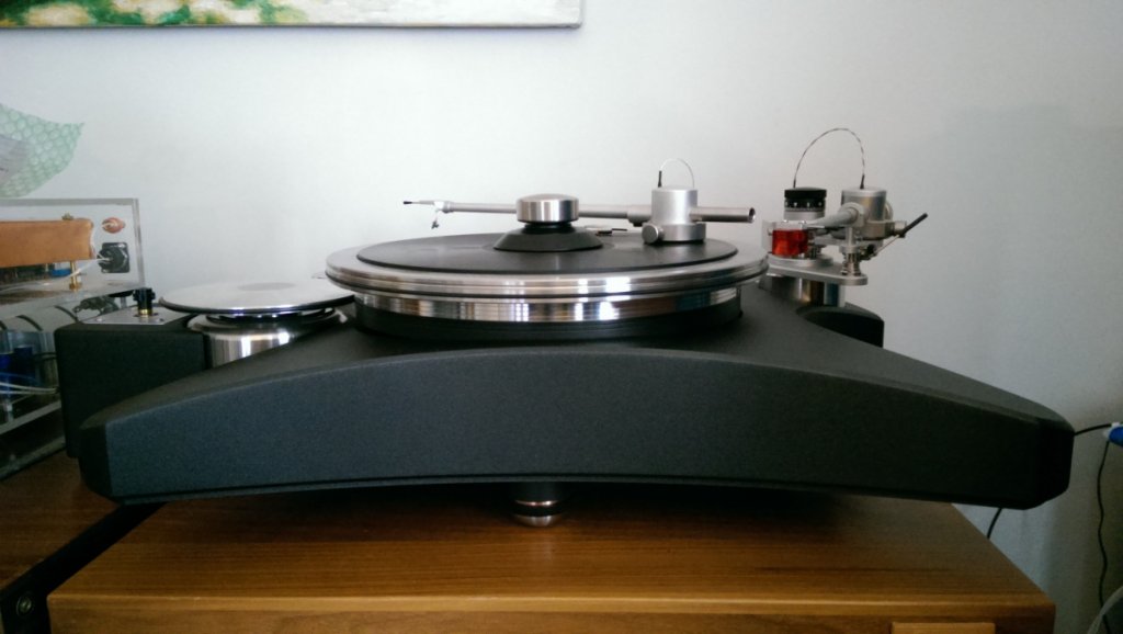

« Reply #1 on: 3 Nov 2014, 06:21 pm »
The plinth is 78lbs.
The two arm mounts and bearing mounts another 12 lbs
The Platter 30 lbs and etc...

Sonny
Re: Ah, another Custom DIY Project Plinth!
« Reply #6 on: 3 Nov 2014, 10:55 pm »
Very nice work. A few questions ...
- What feet are you using?
- Why did you make the 2 front "wings" so large? Is the whole rig more stable that way? Was it because it looks cool?
Great job,
Bob
Bob, those are Magico QPods I am using for the feet.
I made the front "wing" large because I had this 23 x 18 x 3.5 inch plate of Aluminum and did not want to waste anything, and I didn't want to do the 3 "wings" thing as it's too common...then VPI comes out with something similar called the Prime...but i's MDF versus 3.5 inch solid aluminum!

Sonny
« Reply #12 on: 5 Nov 2014, 12:48 am »
Looks great! Paint or anodize?
Powder coated "pewter".  Anodized would have been too much!
Sonny
« Reply #13 on: 5 Nov 2014, 12:50 am »
I don't care what VPI is doing. That is simply killer and very original  :thumb:
Thanks Tom...
I haven't had a chance to spin anything on it...hopefully this weekend and will report!
Total weight is as follows:
Plinth 77 lbs
Leadshot 3 lbs
Arm and bearing mounts 12 lbs
Platter 30 lbs
It's less than my previous DIY table/plinth, but at least I can move it much easier, though it's still a chore to do so.

Sonny
« Reply #15 on: 5 Nov 2014, 12:55 am »
Hi Sonny.
What a special, original, exclusive and awesome looking table you've got there.
Nice work.
Guy 13
Thank you Guy, but I can only take some of the credit.  The designer is very good, machining of the plinth was excellent and the lathe work was too!  And the powder coat, sweet.  All I can take credit for is the ideal, design collaboration, and assembly!

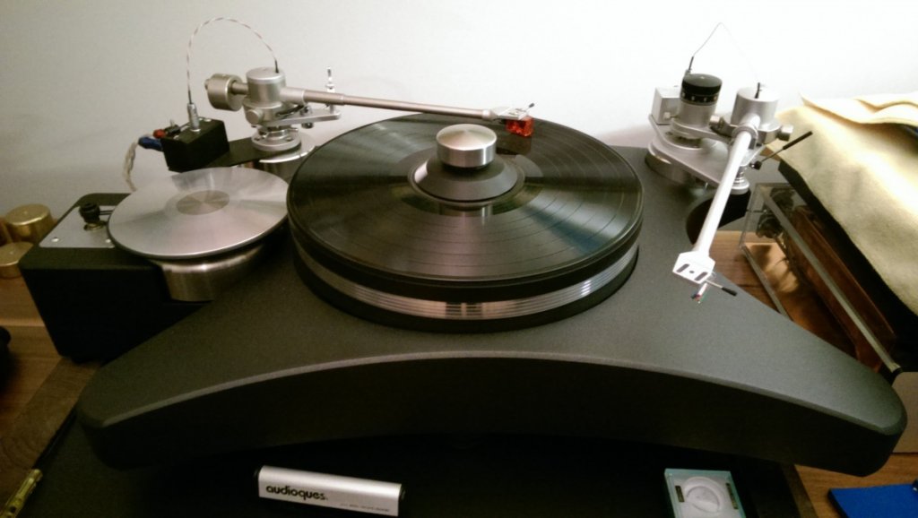

Sonny
« Reply #17 on: 5 Nov 2014, 06:54 am »
Now spinning the Benz ACE mono, with Belafonte "Sings the Blues" and it's really dead, the table.  Blackest background I've experienced in my vinyl playback, EVER!

BobM
« Reply #18 on: 5 Nov 2014, 01:46 pm »
Are those both 12" arms?
