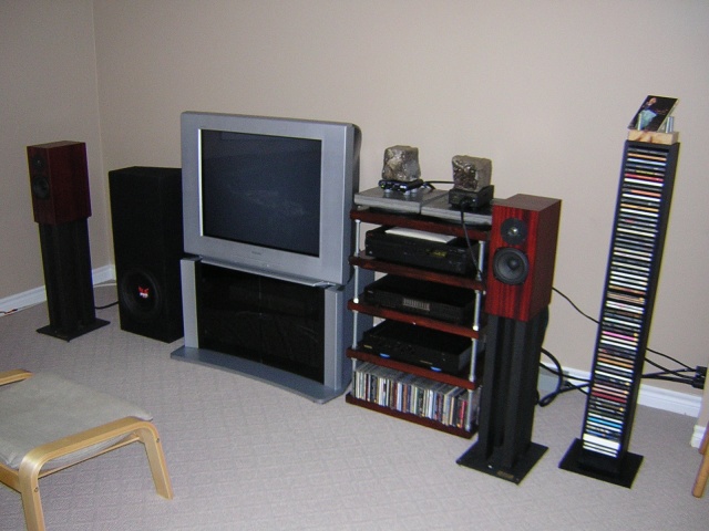

Mresseguie those look really close.  Mine had a small water bubble style level on the base, but those chunky 4 posters look darn near them.
Here's a pic of the system from 2002 or so, with my old Sony Vega 32.
