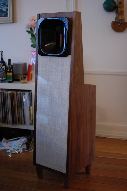

I have owned my RAAL 140-15D dipole ribbons for about 15 months now and absolutely love them.  I am planning a new build with them, "hopefully" the last (yeah right, right?).  I am planning a nice project for a future man cave paired with Accuton C173-6-090 mids and GR Research Servo open baffle subs.  Actively amplified with Hypex UcD modules and preamp/DAC/crossover/processor will be a highly regarded car audio Helix DSP.
The RAAL dipole tweeter employs a formidable faceplate.  How have other owners of this ribbon tweeter integrated it in their designs?  I think I have an idea for how I want to mount it alongside the Accuton mid, likely using a thin wood fascia around the outside to bring the faceplate flush (I am no expert with a plunge router).  Looking forward to what others have done with these :)
Or do I go with the SEOS waveguide, something I definitely want to consider for my build, allows very low crossover for RAAL to cover more midrange:
For science, some examples from around the interwebs:

I will say that using the SEOS waveguide IMO is a bad idea.  The one area where RAAL's stomp everything is in terms of energy storage.  Put it in a deep guide like that and you introduce lots of energy storage, essentially throwing away it's strongest characteristic.

I love how the RAAL sounds w/o waveguide and not using the guides saves me $400 so i am good with that approach :) Now to experiment with xover points/slopes between 2.5k-3k...
First prototype planned for tomorrow!
