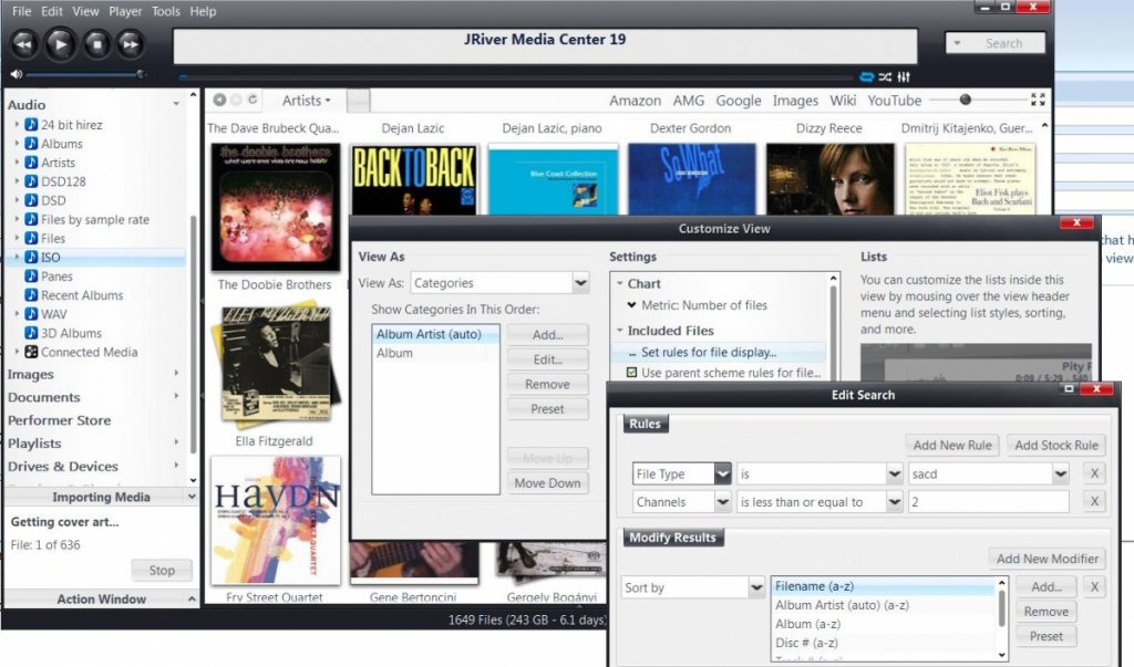

I use the SACD ISO mch view I created on JRIver (I documented here and on CA how to create views that work in Jremote, for example).  The mch ISO view simply allows JRIver to only show the multichannel layer of an ISO so one does not pick the stereo tracks (simple rule is to create "filetype is SACD", and then simply add "channels greater than or equal to 3".)
Here is the same idea (just using stereo ISO rule, i.e channels less than or equal to 2)
