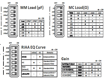

So for MM, the lowest cap is 100pF and 47K is the only loading? I can’t find a large/readable version of the jumper settings.
bacobits1
Re: New Phono Pre—Good with the AT carts, not very expensive
« Reply #4 on: 7 Sep 2014, 09:39 pm »
What was the problem with  the Phonomena II? Under warranty?
Interesting because such a low powered device usually does not develop problems.
The two Pres mentioned the Vista MKII and the iFI could give a "NOVA" Phonomena a run for the money.
I have had all 3.
If you go to the Review "enjoy the music" published it will give you a better pict of the settings.
http://www.enjoythemusic.com/magazine/equipment/0313/ifi_audio_iphono.htm

I see how this works, you get custom cap and loading from the factory. My wires measure at 33pF, and I have never measured the cart's response with only 33pF, so I would be guessing at what loading to have it set for. An interesting choice. Op amps?
bacobits1
« Reply #7 on: 7 Sep 2014, 09:53 pm »
On the Vista the capacitance is not user adjustable you would have to state what you want  when you order. Gain and Resistive loading is adjustable to any resistance you might possibly need.
Resistors supplied should cover most settings. I will say the Ifi is very convenient. But this all depends on how much you change cartridges.
