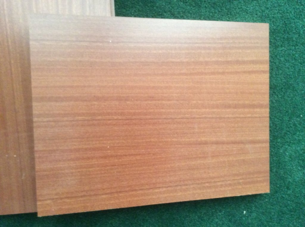

29 Aug 2014, 10:00 pm »
Until I get a flat pack for my new speakers, I now have 3/4" pre-finished Sapele plywood cut into the proper sizes. I'll line the insides with vinyl floor tiles to absorb resonance.

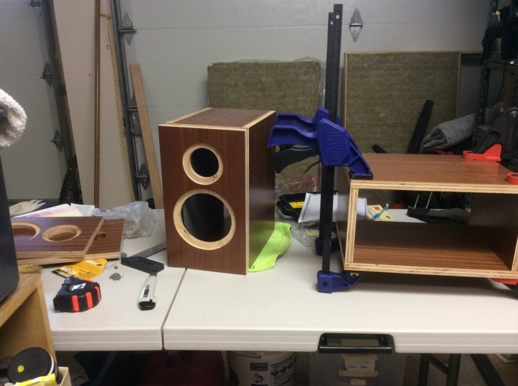

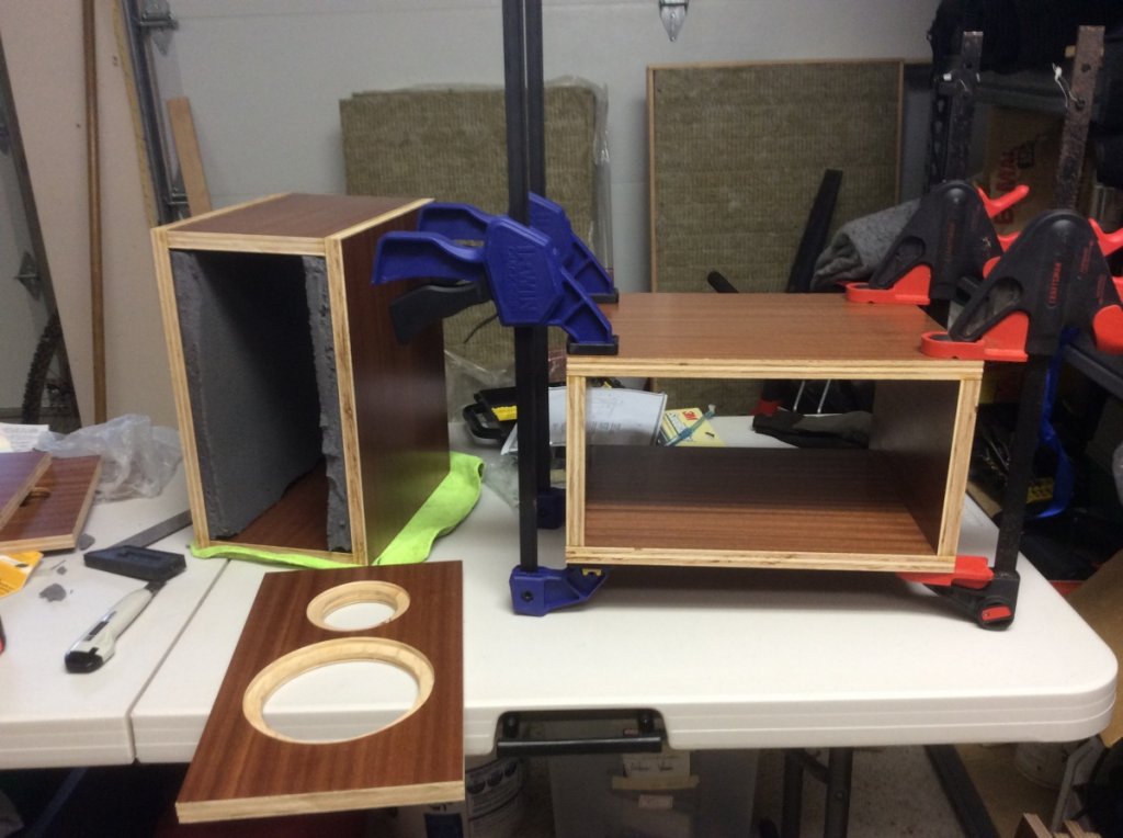

25 Oct 2014, 08:43 pm »
I used to wonder why guys would take so long to begin constructing their speaker projects after posting their initial announcement. I kept thinking, "C'mon, man. Don't you want to hear those new speakers?" Well, now I understand. It's taken me this long just to begin assembling my speakers. I know it won't be long till they are finished and playing beautiful music. The X-overs are already assembled and wainting to be placed. I'm lining the insides with No Rez.
I computed the inside space to be exactly .75 cu inches, so they ought to sound great.
Here are two pics:
Michael
P.S. Those are (unfinished) home made acoustic panels in the background. I used ROXUL insulation.

31 Oct 2014, 06:15 am »
Well, I blew it on the port hole dimension. The hole I cut is the same diameter as the cardboard tube, but the end cap (port cap?) is 1/8" wider. With a lot of sanding and some filing, I can expand the hole, or I could seal the port hole for sealed speakers.
Anyone out there have an opinion...do I bite the bullet and sand my life away or seal the cabinets? Either way these speakers will be paired with my Rythmik F12G sub, so low bass is not an issue.
I'm leaning toward corking the holes.
Michael
