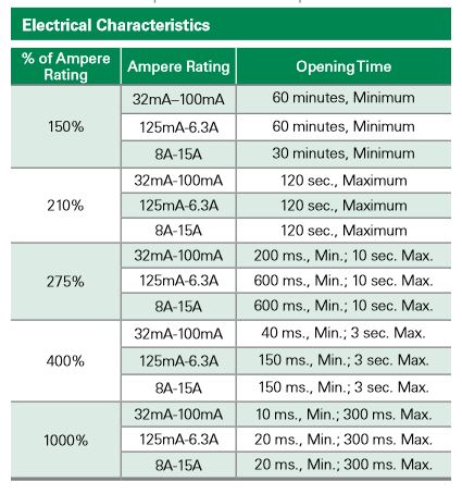

I've never seen an electronic fuse with both Fast and Slow designations or opening characteristics ....
The slow-blow fuses have a "T" marking and are referred to, depending on the manufacturer as
Slow-Blow
Slow-Blo® (registered trademark of Littelfuse)
Time-Lag
Time-Delay
Normally interchangeable, I have read references to small differences in time curves between US and IEC International specs
Here is a typical chart of the Min and Max opening times depending on the percentage of amperage rating for the Littlefuse 218 Series, 5×20 mm, Time-Lag (Slo-Blo®) Fuse
