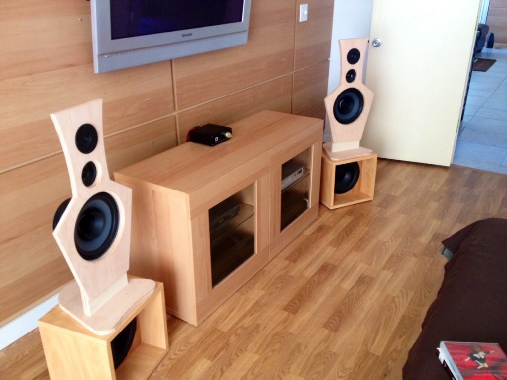

I run the Hestia V Dome in a bedroom, only about 24" away from the front wall due to the cardoid pattern on the dome tweeter. There is no image smearing at this distance. Unlike the others you mention, it is a passive design requiring no MiniDSP and the top section can be run on a single amp. It is also highly efficient and will do well with a relatively low wattage amplifier. There is a complete CNC flatpack available from Melby Audio for the top section, which greatly simplifies having to machine an otherwise complex baffle. Some folks have built this as a top section only, opting to add a bass cabinet later if needed.
Here's a pic showing the distance from the wall.
I may be a bit partial, but I am also very approachable and would be glad to offer advice throughout your build, if you so choose. I would also add that the other two designs are top notch and I am sure you will be happy with whichever you choose.
