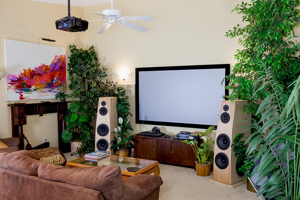

This speaker build is nearing completion and now I'm looking for a replacement for my DCX. It was great to develop the crossovers and it sounds OK, but I would like upgrade with out spending a fortune.
