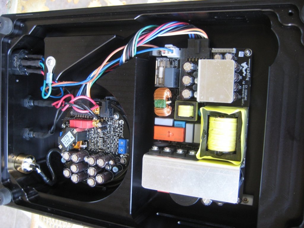

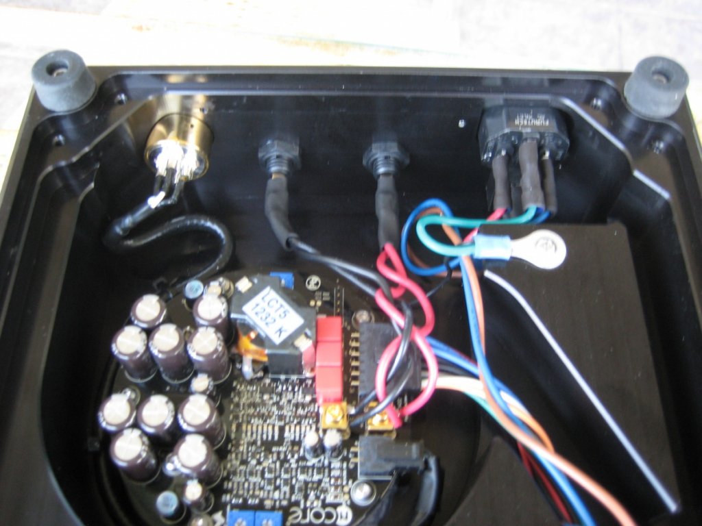

I built some Ncore amps last October.  I showed pictures of the outside, but didn’t show the wiring as I wasn’t very happy with my work.  I had a friend redo the connections to the connectors that I did.  He is a pro at this stuff.  It was my idea to do a 4 wire weave of the speaker wires.  I don't know if that helps or hurts.
Close-up of his work:
Wider view:
Bob
PS My original pictures are now in the intergalactic wastebin.  :cry:

Hi Bob,
Nice to see those babies again!
A braid is always better than straight wires.
Best,
Matt

Re: Redone wiring for my NCores.
« Reply #2 on: 26 Jul 2014, 06:28 pm »
Sorry to say that isn't very good.  Not good at all actually.  You want the wires very tight like this.
« Reply #3 on: 26 Jul 2014, 06:35 pm »
^ Yes a little tighter twist would be better.

  • Posts: 24
« Reply #4 on: 28 Jul 2014, 04:53 pm »
@fsimms I believe that the power wires are supposed to go in the channel that is to the right, as you look at your first picture.  This will keep them further away from the various low level signals.
« Reply #5 on: 29 Jul 2014, 03:36 pm »
Thanks greenkiwi!  I will change them.  :thumb:
Thanks also to jtwrace.  I will tighten the loops up a bit too.  Although, as a physicist, I am not sure that it will make much of a change since these are in a weave.
Bob
