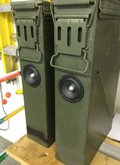

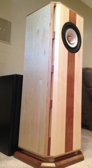

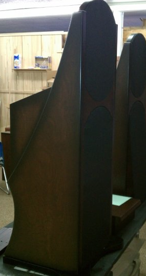

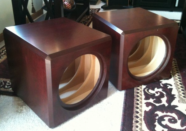

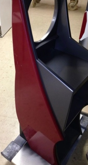

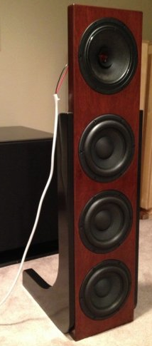

Some my past builds for quality control people....
These are made of Baltic
Baltic also
Baltic Birch also..

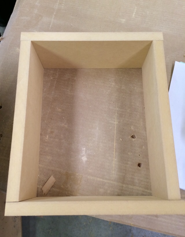

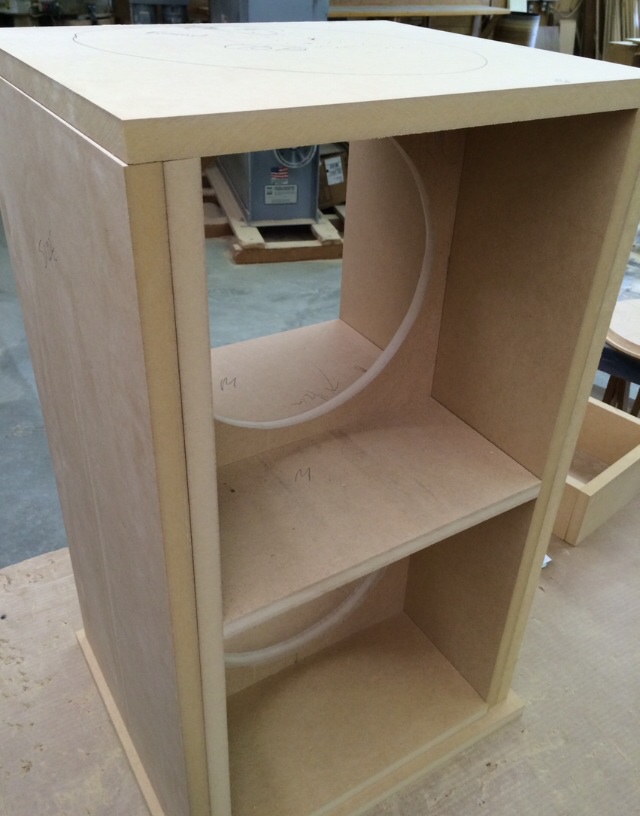

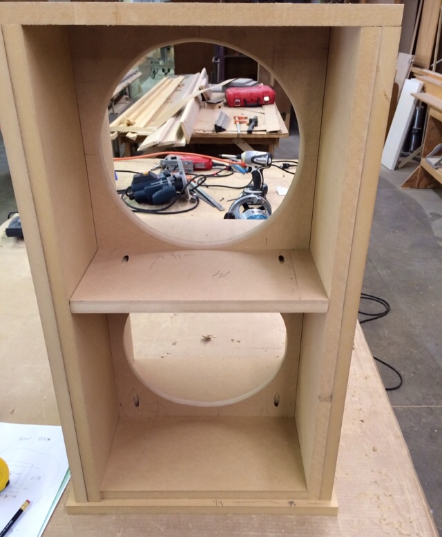

Ok we appear to be ready to go. I have 6 single h frame flat packs with amp box too ready to ship.  The dimensions are roughly 30 x 15 x 18.   Ups is giving me home delivery fees of about 40 dollars from 54601.  This of course is dependent on were you live.  I am going to foam the corners and packing tight. This should be the best proactive way to get them home safely.  The images are exactly how the sub will look minus pocket screws.  The PS continually damaged the Mdf when drilled by someone unfamiliar with product.  No pocket screws.  The construction from bottom to top is as follows.
The following show the dry fit pieces
Bottom stand w 1/4 round over
Bottom sub
Four sides
Two internal divides
Spline with woofer round overs
Top with 1/4 round over
Amp box for drop in
jparkhur
Re: GR Research H Frame OB Flatpack $250 + Shipping
« Reply #6 on: 30 Jul 2014, 02:51 pm »
When you finish these, rolling on primer to non factory edges will take care and make a smooth evenly paintable surface.   Wood glue and some weight or claps will take you through the rest.  Plane on thirty minutes one day and another 20 minutes after glue dries.

Jon---Is the entire baffle one solid piece of MDF with holes for both woofers, with the middle/half-depth/horizontal partitions glued to it, or is the middle partition one piece from front to back of the frame, with two separate baffles, each with a single woofer hole, glued between the partition/sides/and top or bottom?
jparkhur
« Reply #11 on: 31 Jul 2014, 03:05 am »
The spline or baffle is one solid piece.  The separators are just like super v.
