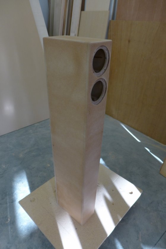

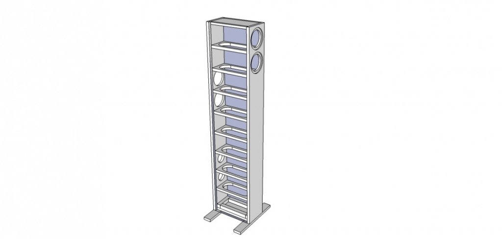

Just put together a prototype cabinet that will use 4 LGK drivers which I'm fixin' to send Danny so he can evaluate it's potential. This is a configuration he suggested and I drew some time ago, but I've been swamped and didn't get it built till now. Might be a pretty cool design, as he said, "it should image like crazy".
Started here, side hidden so you can see the innards

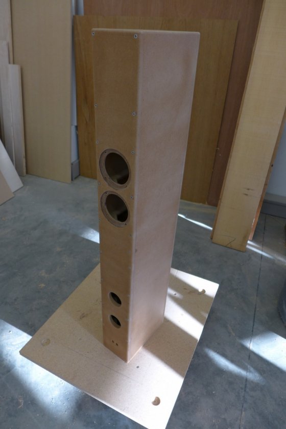

Here's the proto, I made the back removable on this one to allow gerfingerpoken, but final design would have removable bottom for internal access...much cleaner looking. Also will need plinth or outriggers for stability.

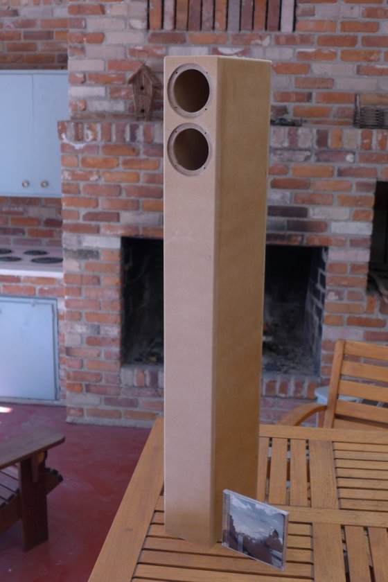

Ed, indeed the size is visually deceiving on these, they are small in stature. 4 1/2" x 8 1/2" footprint, 37" high. When and if this evolves into a viable speaker, I'll detail the cabinet a little more and make the SketchUp model available to anyone that wants it.
CD case gives a comparative sense of scale.

Haha, thanks Peter.  The pic on the table and the CD case definitely help with the scale, they are tiny for a floorstander.  I look forward to reading about how these perform and what frequency ranges they will cover.

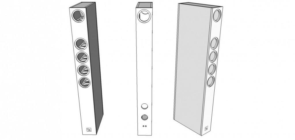

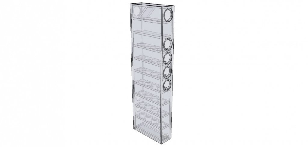

It morphed a bit to make it work out better. Here are the new drawings of the box.  http://gr-research.com/pdf/Fortress%20box.pdf  There might be a few little tweaks to the drawings still.
Peter's building out a pair of the boxes for me and he is converting the drawings into a 3D form.

« Reply #19 on: 25 Sep 2014, 07:19 pm »
 Aaaaaand.........Presto!
