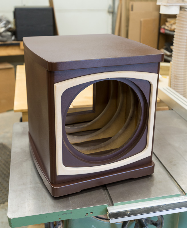

Ron, ...  I just finished a box (almost) for the 12" GR sub and Rythmic plate amp ...  just awaiting the parts from Danny.   I'm hoping for delivery late this week or next (I'm in Canada).
I based the design from one of Rueben's creations (thanks Rueben  :D )  The unfinished grill will just be regular black speaker cloth once I get the magnets installed and frame dyed.

Very nice Scott, I like the black finish you used, can you tell us what type of finish (matte?) it is and how you applied it?

Since this sub won't really be seen,  I just used a couple rattle cans of espresso (dark brown) satin. Nothin' fancy  :)

 Scott -  Your new 12" Servo sub cabinet looks great!  Nice job.  :thumb: It should work really well with your A/V-3 setup. Thanks for posting the picture.
