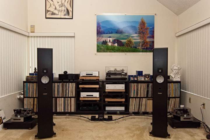

This is a shot of a member's system in his 13'x18' room.  From my experience in a similar size room, I bet this system throws a fantastic stage but you may not think so just looking at it and the reason is that this placement has a good relationship with adjacent walls in a rectangular room:
http://www.audiocircle.com/image.php?id=66308
