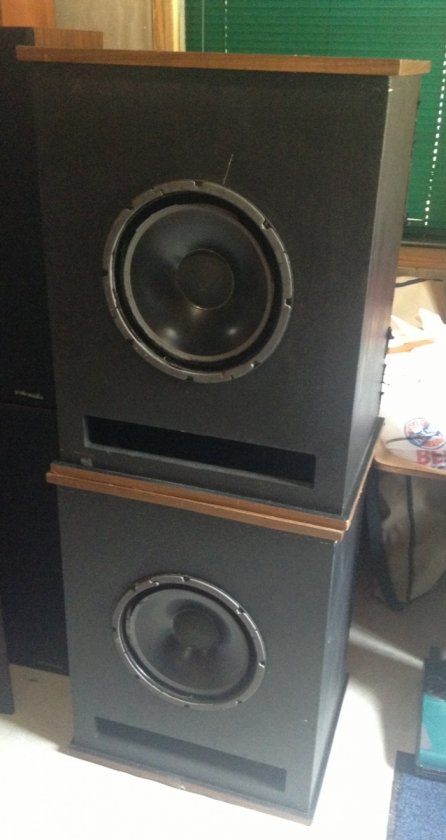

I just picked up a pair of VMPS subwoofers and I believe them to be the Originals.
They measure 27"h x 21"w x 17"d.
12" woofer and slot loaded 15" passive
They need a lot of work but they were free :D
Where is the best place to order surrounds for these?
Are they the originals?
Does anyone have specs for them?

Yes, that is called the ORIGINAL sub since it is the Original Sub Brian produced.
Listed specs are:
Frequency Response: +0, -3dB, 20Hz to 600Hz
THD: 2.5% max. 20Hz to 600Hz
Sensitivity: 90dB/1W/1m
Impedance: 8 Ohms
Power Requirements: 20W - 200W rms
Dimensions: 20 x 27 x 17"
We have a new 15" Passive Radiator, that will extend  the lower responses a bit.
Not sure those are stock woofers, since they don't appear to have phase plugs, but dust caps instead.

I popped the woofer out and I think it is original as the monster wire is soldered directly. They look the same as the only other picture I found on the interweb.

Yours might be from before him using phase plugs.
He told me the ORIGINAL sub was designed to be used and blended with the QUAD speakers, which had little bass response to speak of.  Later he also used it with other speakers he helped design or worked on.
Later he built a larger sub with a bigger box, and an additional 15" driver.  Since it was larger than the ORIGINAL he called it the LARGER SUB.
Then next he designed and built a smaller sub with a 10" active and 12" Passive.  Of course since it was smaller, it became known as the SMALLER SUB.
Then after he designed the 626, which had 2 6" woofers and a 2" tweeter, he designed and built a Sub that the 626 could be set on that would be the right height for normal listening.  Initially it was dedicated to being a stand and sub for the 626.  This sub then was known as the DEDICATED SUB.
The UltraMega PRs are $115 each plus shipping, and will make a MAJOR difference in the performance of the sub. . . .MAJOR.

How do you get to the passives? I took a quick look at the bottom of the speakers but did not notice any screws.

I have one just like it. There are four large screws on the bottom, once you remove them,  the whole bottom slides off revealing the passive. Good luck

Also, Simply Speakers have 12" Butyl  rubber surrounds #RSK-12A which will last longer than the foam. For the passives #FSK-15F is what I used, which is a foam surround, Not sure if they have butyl rubber surrounds in 15".  Good luck with the refoam job.   :thumb:  Vmps ROCKS

I have an older pair like yours that doesn't use screws on the bottom.  It is attached using long staples.  Turn the subwoofer upside down and use a sharp flat-blade screwdriver to pry a bit of one end of the bottom plinth loose.  Then you can work around and loosen the rest of the plinth.  Don't bend the staples because you can align them with the holes when you reattach the plinth and just tap it back on with a soft mallet or hammer.

I actually looked at them this morning and was able to pull off the one bottom with relative ease. I will use screws to put the bottoms back on.
