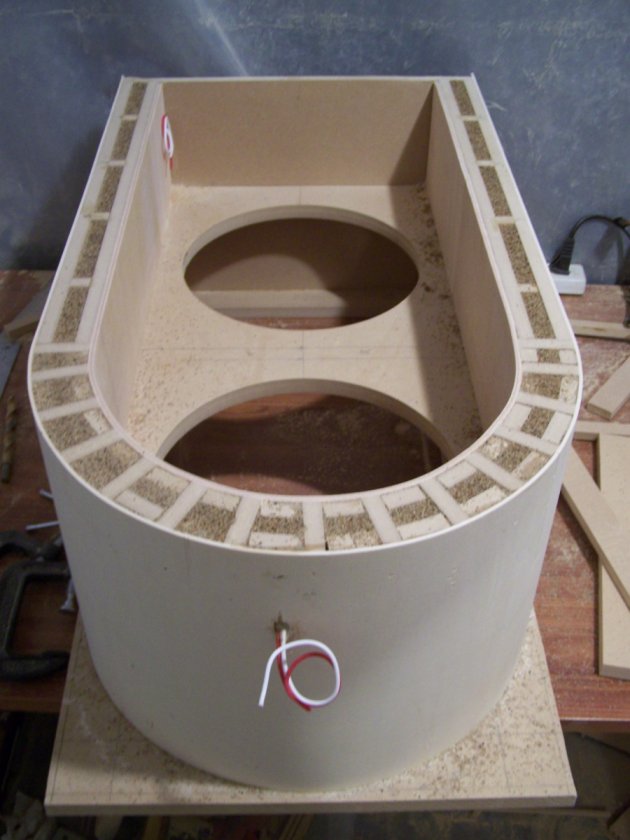

PDR
  • Posts: 820
  • May the best man win
Re: Something new that sounds incredible
« Reply #595 on: 22 Nov 2014, 10:46 pm »
If your going 1-1/2" wide on the sides, maybe consider sand filled.
It was the best decision I made when building my Super V.
Gives a great place to conceal the wires as well.

« Reply #596 on: 23 Nov 2014, 06:37 pm »
That looks really good but boy does it look like a lot of work and heavy!  I want something sound but something I can move both now and in the future.
I wondered how you got the curves on your speakers, now I know.
Mike
bdp24
  • Posts: 888
« Reply #597 on: 24 Nov 2014, 07:10 am »
Mike, there is a thread here on AudioCircle GR detailing Lundy's entire build of the "Jukebox" Super-V's. Genius!
