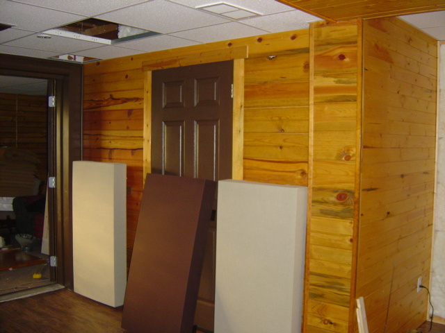

I've got 18 GIK traps, and I'm dealing with an uneven back wall (underground side of the house) in my basement studio control room. I've got a bathroom wall (9 ft. wide) that is 16 ft. from the front wall that I can put 3 244s on, spaced 4" out. I'll probably put another 244 on the corner door in the left corner as shown in the first picture. The other side is an alcove (6 ft. wide) that is 22 ft. from the front wall. I'm building 17x17 soffit traps in the corners of the alcove. I'll probably put a 244 in the center between the soffits, but I'm not sure what to do with the side walls in the alcove. Should I just put a couple more 244s there? I've got 16" of insulation above the drop ceiling. Am I on the right track with this setup?

Sure a couple more in that area would be fine.
One other tip, if you have not done this yet, is to fill the empty space above the drop ceiling to create a HUGE bass trap.  :green:

   I've got 16" of fluffy above the drop ceiling. Should I place the 244s closer to the floor to catch the floor/wall corners better, or should I just center them on the wall? My monitors are angled down slightly, the left one shooting towards the bathroom wall, and the right one shooting towards the alcove. The 244 on the far left is actually mounted on the wall about 2" off the floor. How high on the wall should I have them?

Thanks again Glenn - Here's a pic of the bathroom wall with the 244s on it. It's hard to see in the pic, but there's a dark brown one on the door. Since there's 16" of insulation above the drop ceiling, should I keep the 244s closer to the floor, or centered on the wall? I've also got 2 diffusers (like the white one in the pic). I could put them above the 244s, but I'm not sure if they'd do any good since I'd be sitting about 9 or 10 feet from them. I guess I'll just have to figure out REW and just try things out.

I would leave the trap where it is. The diffusion above the other traps is not a bad idea.

I'll give them a try above the 244s on the bathroom wall. I'll probably be sitting a bit less than 10ft from the bathroom wall. The alcove sits 6ft. deeper. I thought about putting them vertically between the soffits, but maybe the deeper alcove would need more absorption than diffusion.
