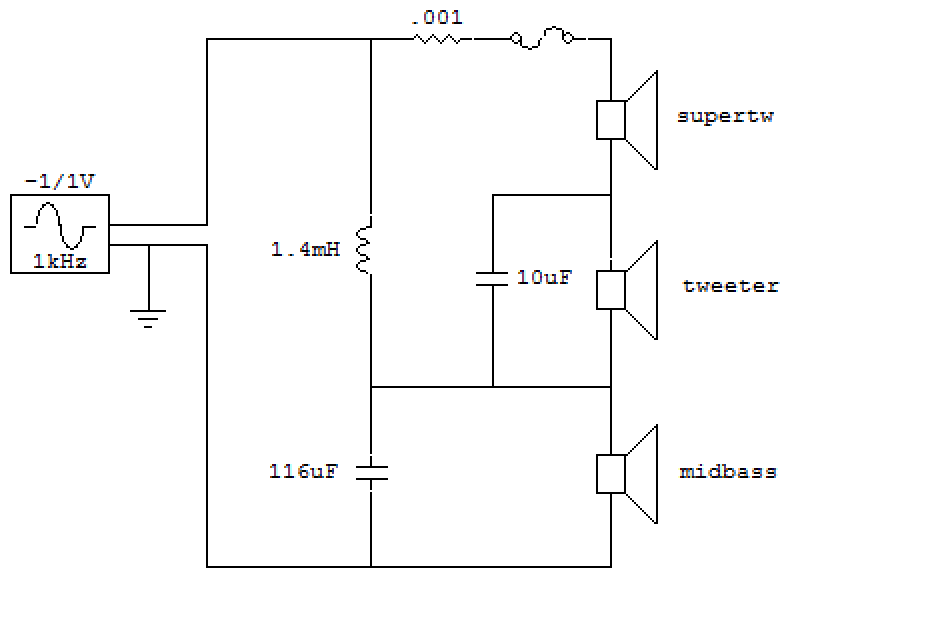

Actually, like him or not, and agree with him or not, Peter Gunn has posted a circuit. I'm not a fan of how it's laid out, but here it is:
When I simulated the circuit, I divided the 4 ohm load in thirds - 1.33 Ohms each for Super tweeter, Tweeter, Mid bass. Probably an incorrect assumption. I'm guessing ideally I should dig into the speaker, disconnect the crossover and measure the DC resistance with a handheld multimeter.

Yep, I've seen that schematic.  I have little confidence it's correct.  :)
Even if it was, you'd still need exact impedance of the drivers to fully simulate.
Dave.

The schematic has to be wrong since it leaves no filters to do midbass/tweeter - it's missing at least one inductor.

The schematic works for me. It is the same as the crossover in my 1.7s. I didn't have my speakers too long before i updated the crossovers but i know they sound awesome now and have plenty of bass.

Assuming that schematic is correct, I wonder if you fellas have noted the puzzling configuration and that this is not a series crossover?  :)
The woofer is connected in a normal, parallel configuration.  Only the tweeter/supertweeter are connected in a quasi-series configuration.
(edit)  I've redrawn the schematic with normal convention so it's easier to understand.  Actually, it is a series connection for the woofer, but the high-pass configuration for the supertweeter leaves me puzzled.
I still wouldn't be surprised if that schematic is not correct.

The bass seems to have a second order low pass filter. There has been a lot of talk about first order filters in the .7 models....
No, it's actually a first-order network.  Only the addition of the 10uF capacitor alters the configuration from the classic two-way series network.
The interesting thing about it is the supertweeter has the same high-pass cutoff as the tweeter.  It might function as a supertweeter but it's not driven that way.  :)
The 10uF capacitor rolls off the highest frequencies applied to the tweeter (slightly) relative to the supertweeter.
It's not the way I would have implemented this crossover (because of the huge capacitor required.)  :)
My standard caveat......assuming the schematic is correct.  :)
Dave.

I do not get it. There is a coil in series and capacitor in parallel to the bass driver. Is that not a second order filter?
Yeah, but the coil is not really in series with the woofer.  The tweeters shunt the coil, and likewise the woofer shunts the capacitor.
This is the standard configuration of a first-order series crossover.
