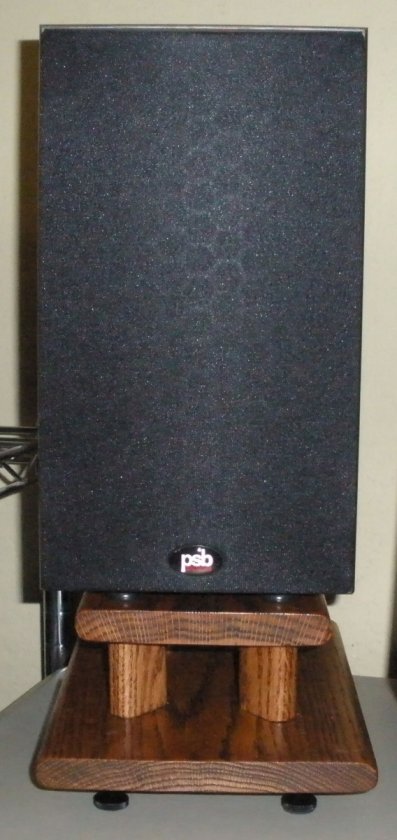

Would putting a speaker stand like this on top of the X-sub and putting the X-LS Encore on the stand work?

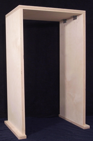

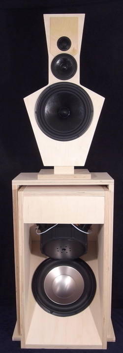

Linkwitz uses a bridge over the woofer box for this in his LX521
But these are open baffle speakers so I don't know if this type of stand would work with the X-Sub since it is down firing and the closed sides of the bridge might pose a problem.

The problem that I see what that particular stand is that it is very prone to movement by the drivers that are mounted on it. But, it is a right idea.
Make a stand out of the sub with side panels supporting the upper panel that the speakers sit on so that the speakers aren't in direct contact with the upper panel of the sub. You don't want it to sit on the top of it.
