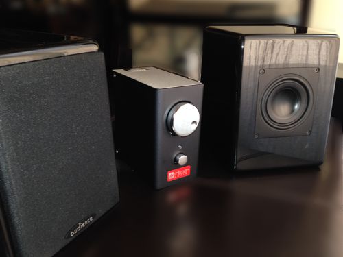

A bit self-serving to suggest it, but worth mentioning this very limited time offer.
Audience THE ONE
Virtue ONE.3
(basic cables/monoprice - free)
http://store.virtueaudio.com/product-p/combo-vaone.3-theone-1.htm
I'll be out for the next 2 days but read up on THE ONE speakers.  They really sound unreal with my little amp and you can buy a subwoofer cheaply to pick up the bottom octave.
It's a very attractive, "no compromise" solution that is just at your price point.

I'll say upfront that I haven't heard the Audience The One speakers but I did have a chance to hear the Audience ClairAudient Loudspeaker 1+1 speakers.  The 1+1 speakers are essentially the Audience One units in a slightly larger enclosure which has passive radiators to enhance the bass performance.  The One retails for $1000 while the 1+1 model goes for $1800 per pair.  You can see them at:  http://www.audience-av.com/loudspeakers/index.html
While the Audience speakers have excellent finish and look very nice, they have a very low performance to cost ratio in my opinion.  Danny's N3  speakers at the kit price of about $500 will kill the Audience units in every performance spec you wish to consider.
