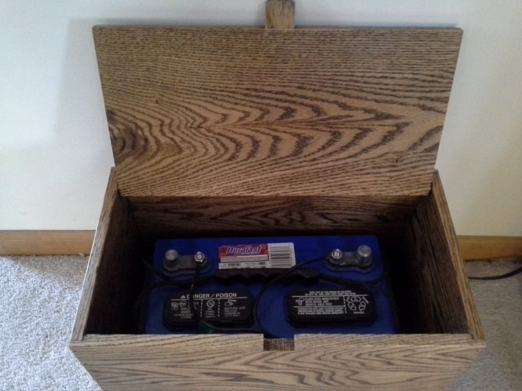

I have a 12 volt battery power supply for my buffer. I would like to add a meter to it.
Just to know exactly what condition my supply is in/at.  But, not sure if a typical volt meter would be best or
Maybe an ampere meter might be better. I am currently using a 12 volt beep cycle (marine type ) battery.
Any ideas/suggestions ?
Thanks

More importantly, you should NOT be using an open acid battery inside your house.  One little spark.....
Get yourself a sealed battery.
Yea, I have sparks all over my living area.   :roll:.. I have had batteries actually blow up in my face, and it requirs a large amount of fumes and a very leaky, poor battery, along with a very large sparking source. Being struck by lightening is more likely. But, thanks for your concern.

bladesmith, when a lead/acid battery of the type you have charges it produces HYDROGEN GAS, remember the Hindenburg. When you confine the hydrogen gas,as you have done in your very nice looking battery box, the chances of an explosion are multiplied.
Scotty
Scotty
(Now, I have the Hindenburg in my living room,  :lol:)
Have you even read the title to the post ?
Or do you just go around thread killing ?

He's probably right. That battery box is not going to confine hydrogen.
If you hadn't issued a safety warning I probably would have, though.
Building a battery meter is notoriously difficult. Even if you count every milliamp-second in and out, you still have self-discharge to account for. Traditionally, lead-acid batteries are managed with a voltmeter and an experienced eye. In days gone by a hygrometer would have been employed too, but we just top batteries up to a level with distilled water now, if at all.
