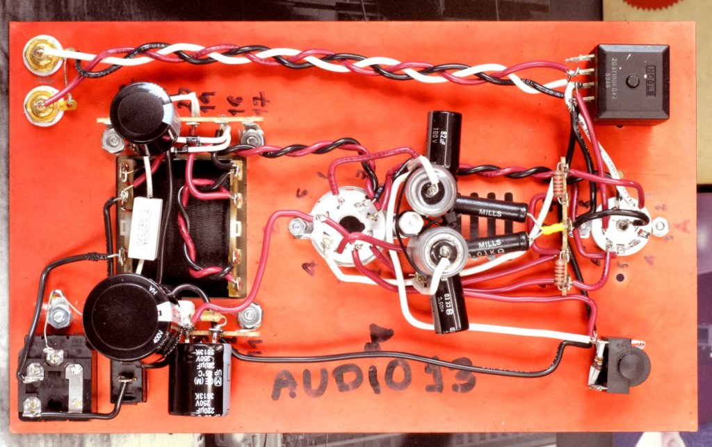

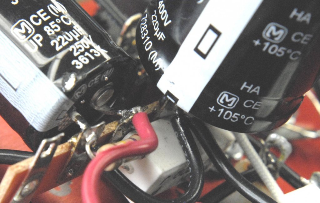

I had a 50Hz humm with my Crack, is was consistent regardless of the setting of the volume control, is was lound enough to be annoying.
After posting some under the hood pictures of my Crack, the people at Bottlehead forum told me that there was one small 220uf capacitor missing.
After a nation wide inquiry, my wife and I found out that the capacitor had fell off his nest. I've use a capacitor that I had here and did a test with some jumper wires and the humm was gone, was a thing of the past, was no more, did not exhist...
Tomorrow, I will see the soldering master and he will make the installation permanent.
Voila. That's it.

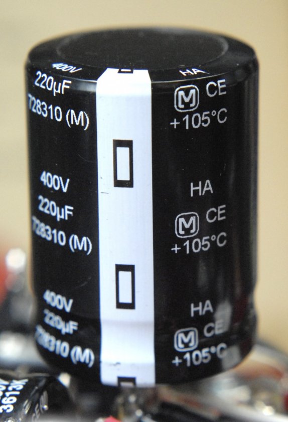

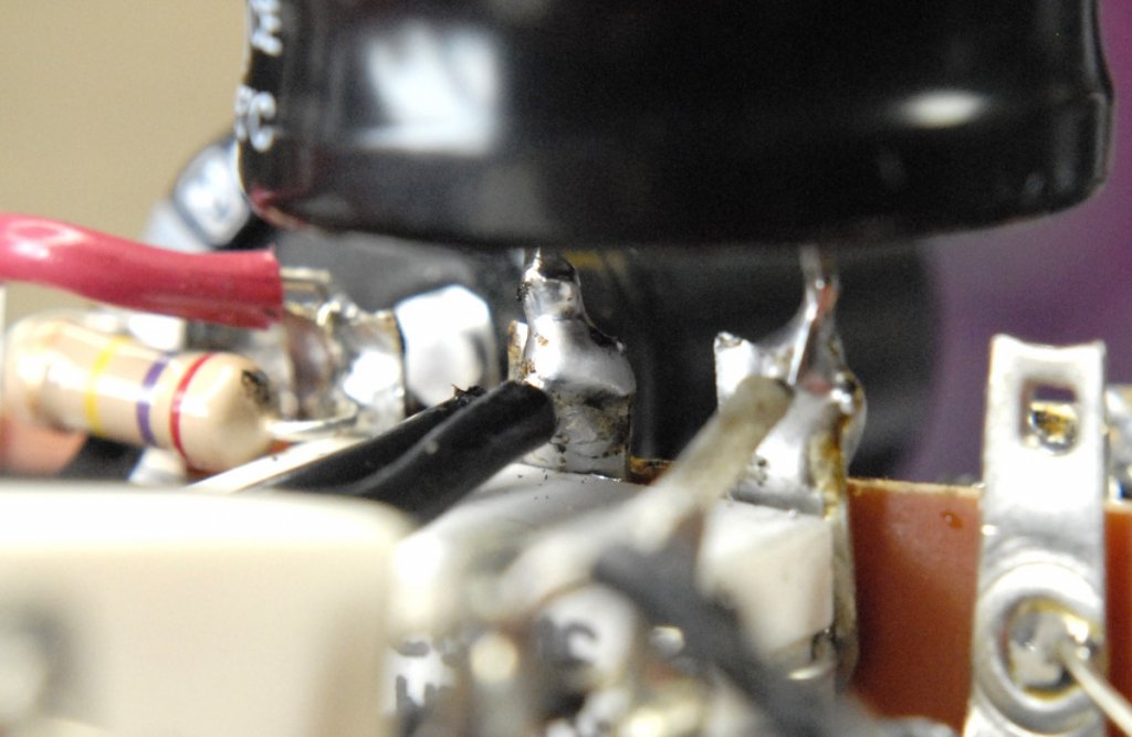

My sick Bottlehead Crack that needed to have a capacitor transplant came back from the emergency room and he’s now in my reanimation room or if you prefer; in my listening room.
As per the pictures below, you will see that the Vietnamese doctor did a decent job and most important, he did not charge me exorbitant amount of $$$ as many other doctor would do for such a small operation.
Soon, I will check the blood pressure or all the resistors values and then check the hart beat or all the voltages throughout the operated body of my Bottlehead Crack.
