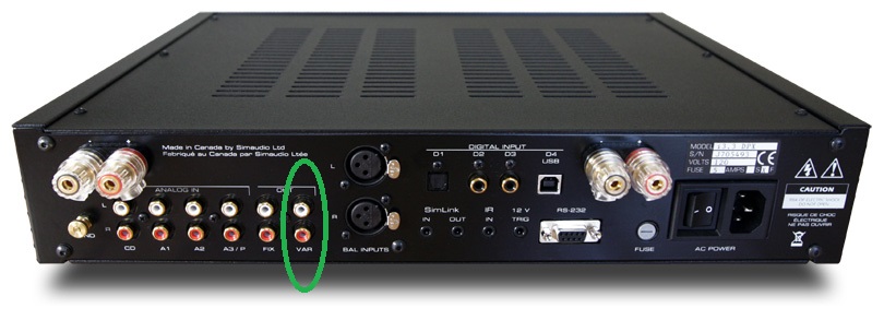

Looking at a Simaudio i3.3 amp, it appears that you do have a preamp output to feed a subwoofer.  On the back panel there is both a fixed (FIX) and variable (VAR) output, and the variable output would be your volume-controlled preamp output.
Is your amplifier different from this photo?
Steve

He might be looking for a mono sub out. But the variable preout can work as most sub will have its internal low pass.

Thank you! The back of my amp is the same. I am thrilled to learn I may add a subwoofer after all. I'm just a little irritated by the poor advice I was given by the 'knowledgeable' sales rep at a brick & mortar shop. Honestly, after that advice, I didn't look closely at the connections. My lesson for tonight is "Always learn everything about my electronics."

Look at what I found while really reading the Simaudio i3.3's manual:
"The MOON i 3.3 integrated amplifier also has two pairs of non-amplified outputs labeled ‘FIX’ and ‘VAR’, located next to the A3/P input. The ‘FIX’ output is intended as an input to a recording device such as a cassette tape deck or CD-Recorder Player. Keep in mind that the output level is fixed and cannot be adjusted by the i 3.3’s volume control. The ‘VAR’ output is designated for output to a power amplifier with single-ended RCA inputs in the event that you wish to use your MOON i 3.3 as a preamplifier only. Keep in mind that the output level is variable and adjusted by the i 3.3’s volume control."
It seems a little reading goes a long way.
