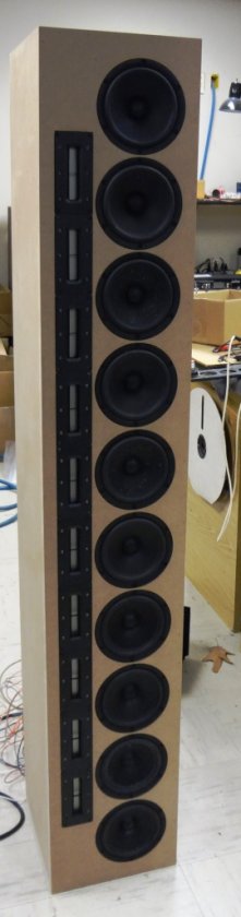

Two lines of neodymium-driven drivers...

This is the first straight array using ribbon tweeters that we've applied resistive shading to (thanks to Don Keele for his work in that area). The initial results have been excellent and I look forward to hearing back from our NY customer building the kit.

Pretty cool.
How does the shading compare to an actual CBT?
Able to share info on the design? Drivers, kit price, general performance specs.

Pretty cool.
The shading is different than a CBT but the principles are the same. Satori 6.5" woofers and Fountek NeoX3.0 tweeters. The sensitivity is 95db and impedance about 3.5 ohms (active/DSP crossover). It's a sealed box which can be crossed over to subwoofers or can be equalized to add bass extension and used full-range without subs. Right now I'm still testing so I don't have any response graphs; however, without any response correction the results have been looking very good. The first kit is being calibrated with a DEQX but I believe a passive crossover option might be viable.
One note on the resistive shading. It has come to my attention that another designer has been trying to scare off potential customers saying that the resistors are a fire hazard. I have had no issues with any of my speakers using shading; in fact, one of the CBT arrays was recently driven with an amplifier capable of over 1,000 watts RMS with zero issues - 2.5x the maximum power I specify for it! It's easy to test this outboard and playing the LiNEOceros really loud produced virtually no temperature change in the resistors - slightly warm to cold at touch. I hope the person behind this will realize that he needs to get all of the facts straight before he starts running his mouth.

I did some power testing with the ATI amp. With 225 watts into 4 ohms I had 118db peaks at 1M with no clipping. Next I'll run distortion tests at different levels.

I've received some requests for pricing on the Lineoceros kit. The cost is $7,000/pair including shipping to the mainland USA. The kit has everything you'll need except for the cabinets and internal damping material. At this point no passive crossover version is available.
