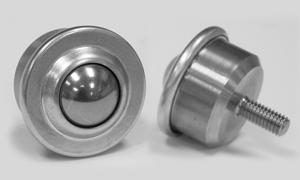

Also- for the legs, I ended up with "ball transfers" attached to my steel frame.  I thought they looked much better than most of the casters.  As a plus, they rotate very freely in any direction, are available with nylon non-marking ball, can be tucked up almost invisibly in the frame and had a 250 pound/caster capacity.  Sourced from a US manufacturer at a very competitive price, who also had them in stock.  I had never even heard of these until I was searching for low profile casters.  I'm curious to see how they'll hold up- but the seem very sturdy.

Those look very cool, indeed.  The casters are hidden in our cabinet design (which rides only about 1/2" above the floor).  The transfers look like they can be likewise hidden.  I didn't know they existed when we built ours about 10 years ago.  But what kind of prices did you find compared to heavy duty casters?  Any issues with them on laminate or wood flooring?

Mudslide- I found the ball transfers to be much more competitive over quality casters, plus they don't really look like 'casters' and are very low profile compared to traditional casters (big pluses for me).  The ball itself can be carbon steel, stainless steel, or nylon.  I went with the nylon as it is non-marring.  Cost is all over the board for these, but the #250 capacity nylon pieces that I got were less than $15/ea (in quantity).  There are a lot of vendors (and auction site) sources, I found a US company that makes their own with domestic sourcing for the materials.  Some of the higher capacity units get pricey in a hurry- in the $70 and up range, but depending on the style and capacity needed might be worth it.

Yetis- if it's not too late, you might want to search out the ball transfer units- the ones I picked up are rated for  800 pounds for the four of them- and there are higher capacity ones as well.  The ones I picked up are under $20 each.  Nicely made and the move well in any direction.
You had the same reaction that I did to the wheel based casters, that's when I looked for the industrial style solution.
