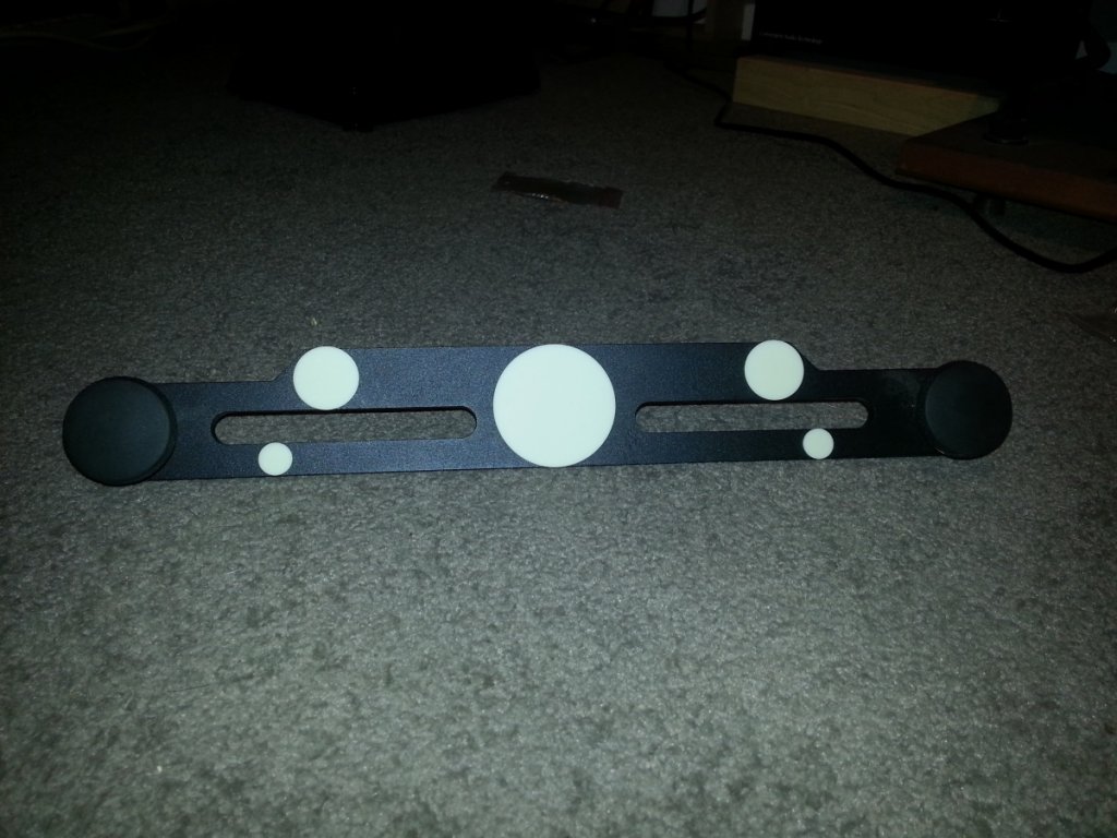

I had an idea - don't know if it'll be effective but what the heck why not-
I am about to start using Soundocity outriggers on my new Revel F206s and I thought that I would try to decouple them from my speaker. So I picked up some Grungebuster dots of what I figured would be the appropriate size and came up with this set-up (excuse the cell-phone camera):
I can't say that I definitely hear an improvement but the dots do reduce the vibration of the bottom of the speaker, and they must be reducing energy transfer to the floor so it's all good.
I wanted to share as I think if you made kits specifically sized for the outriggers it would work even better than what I have cobbled together.

Interesting -- I use the Outriggers and never thought of decoupling them from the speaker. Curiously, I use Herbie's decoupling footers under the Outrigger spikes to protect my wooden floors, and found them to offer some improvement (see review in Affordable Audio). I think your idea of using Grungebusters is worth a try, though I would dread having to fit them to my super-heavy speakers now.Of course, curious minds want to know...

Sure, I can make a Soundocity Outrigger "kit." Grungebuster Dots are not the most appropriate material, however. You would want to use "Thin" Fat Dots instead, made of Herbie's dBNeutralizer material. If you let me know the size "diameter" of the Dots you used, I can duplicate them with "Thin" Fat Dots and set a special price for the kit.
(Most essentially, decoupling/isolating with Herbie's Cone/Spike Decoupling Gliders under each of the Outrigger spikes is really beneficial sonically, plus accommodates easier movement of the speakers when needed.)
