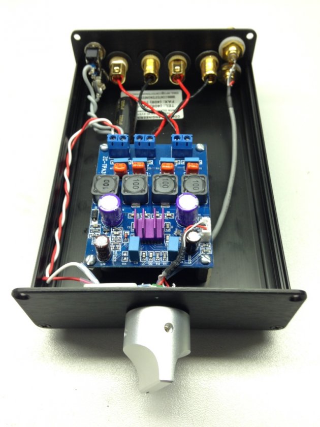

Slight problem with the tour amp. I got a PM from the next person on the tour - 'Got the amp but there is a problem.  The upper input is loose.  No sound is coming from the left speaker.  What should I do?'
I was able to get sound from both speakers but I did notice the same thing. I think there is a thin bolt on the outside of the case that I think holds the input tight against the case. Maybe there is another thin bolt inside the case that is loose? Should the person open the case and take a look? It is not my amp so looking for advice from either rhing or shadowlight on what to do next.
rhing
Re: TPA 3116 listening tour?
« Reply #58 on: 12 Jun 2014, 09:20 pm »
Here is a photo of the amp. I'm surprised that the left channel input is loose, but if someone was using a collar-tightened WBT-type RCA connector, that could explain why it worked loose and is probably now detached. There's no way that transporting the amp via normal shipping would cause a connector to get loose. If no signal is coming from the left channel, then the circuit was broken.
Either send the amp back to me for repair, or try repairing the input yourself. PM me if you want to send it back.
murphy11
« Reply #59 on: 13 Jun 2014, 03:06 pm »
thanks for the info! Does opening the case involve simply unscrewing screws? I pm'ed the person who has the amp and maybe we can open case, inspect and take a pic to diagnose before determining next steps.
I did use Kimber Silver Streak WBT cables to connect my laptop to the amp. Maybe connecting/disconnecting somehow damaged the inside of the amp. It's weird though because I had no trouble connect to the inputs - they connected easily. I struggled a little bit with the spade connectors on my Anticables on the speaker terminals but not with the inputs - hmm.
