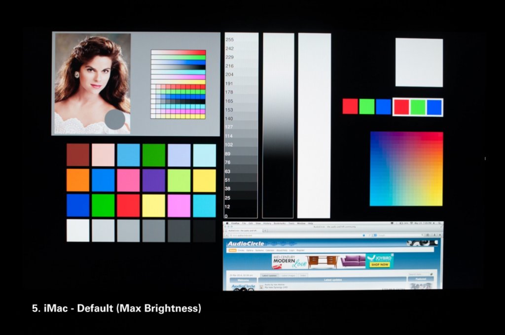

The profiles created are noticeably different to me. even the iMac default vs iMac Calibrated are different. Below show some examples....

Maybe this will work, maybe not.....the other day I attempted to take screen shots to capture the different profile results. but OSX does not take the display profile into account for screen shots. So I set up my camera on a tripod and took quick images to show the
relative
difference between the profiles I have currently. These, in no way, are accurate for color or dynamic range, but they show the relative difference. The funny thing is that unless YOU are viewing these on a somewhat accurate display they will likely look very similar.
1. iMac OS Calibration Assistant
2. Xrite_Calibrated in Afternoon Daylight (closed window shades)
3. Xrite_Calibrated in Dark Room with small lamp - No Auto Ambient
4. Xrite_Calibrated in Dark Room with small lamp - with Auto Ambient
5. iMac - Out of Box (Max Brightness)
NOTE: the profiles 1-4 are based on the Xrite calibration Brightness setting with is around 55%. Also the iMac out of box image is a bit brighter than to the eye. But I didn't want to take the time to figure the absolute perfect exposure. screen shots are tough.

Hmmm.... interesting. Viewing on my 13" MBP non-retina in my dimly lit room with 27" LCD TV on in front of me. I set my brightness about 80-85%
#5 is way too bright, but that's kind of expected. The sad part is that most people (non photographer, graphics related) will be using their Mac this way.
#4 is a bit too dark.
#3 and #2 are close. But I feel #3 looks better to me.
#1 is close to #3 of which I think looks best, just a tad lighter. Not bad for a built-in calibration.
Of course this is not absolute since we are talking about screen shots here. Are you setting the exposure based on which one?
How your photos looks on other screens that you have seen?

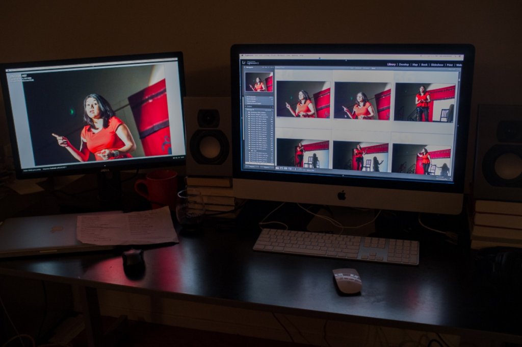

the Dell U2412M 24-Inch monitor showed up today--thanks Amazon!
I see that I can use it as an second display with the imac 27 in Lightroom-lots of options. I didn't calibrate the DELL but knocked down the brightness two clicks. and there is a noticeable difference in the image rendering. the iMac calibrated is still very dark. I have 600 images to sort through and the dark lighting shows up clearly different between the two displays. This project is screen/web output only so I am still dialing it in.
I think having a couple of monitors will help me see what others will see.

jqp, It is awesome to have a NON-GLOSSY display. the iMac screen reflectivity definitely has its shortcomings. the off angle viewing on the DELL is very good. but, as stated, it is uncalibrated, but good out of the box. I am just using it as the secondary display for Lightroom work, to see the range of possibilities of how images appear.
But I mainly bought the DELL to be the display for my work MacBook Pro when I work from home for my day job. I was very surprised, that I can't use the iMac as a monitor for the MBP...vintages matter.
