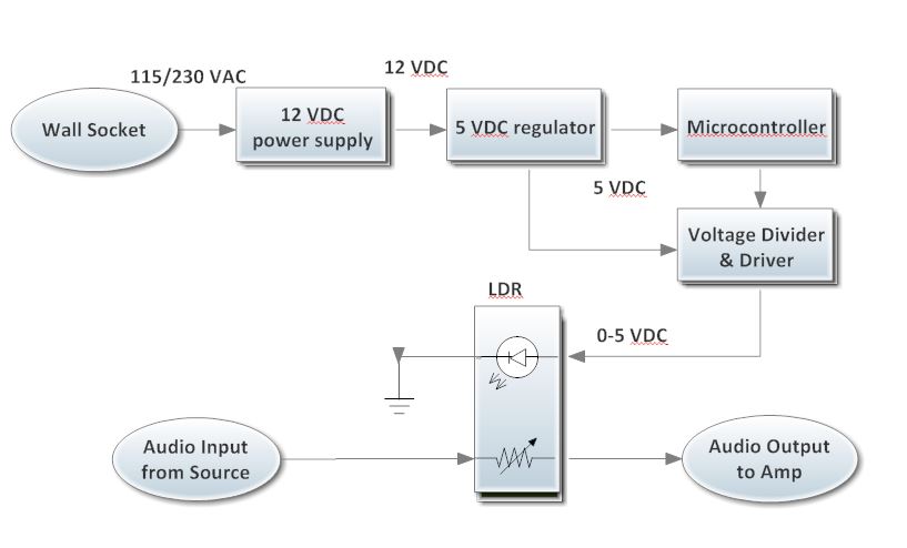

      Morten, would it be accurate to say that:
The active circuitry of Tortuga LDRs is only used to control a micro-possessor to determine the equivalent resistor values of a light dependent diode.
       If that is not completely accurate, how would you better restate it?
Simplified, it looks more or less like this diagram.
The audio signal passes "passively" through the variable resistance of the LDR insofar as there's no deliberate attempt to do anything to the audio signal except attenuate/modulate it's signal strength going to the amp. Passive in that the power supply does not directly interact or "touch" the audio signal as is the case with a buffer or active preamp with/or without gain.
However, the resistance of the LDR is indeed actively regulated by the software driven control circuitry which adjusts the light intensity of the LDR's internal LED (light source).
Where the "better tasting, less filling" debate comes into the picture is the fact that the active circuit is communicating with the variable resistor optically. What is that? Active or passive?
In my view it stops being purely passive given that artifacts in the active circuit's power supply can be optically communicated to the variable resistor and thus imposed on the audio signal. I'd initially thought that  the power supply couldn't possibly impact the audio quality because any artifacts in the control voltage would get filtered out and not be "seen" by the audio signal. It appears I was wrong about that.
Optically isolated or not, that old rule in audio that it's all about the power supply applies here as well.
How about actively controlled optically transmitted variable resistance passive preamp?  ACOTVRP(squared).  :scratch:   Nah. Passive Preamp.  :thumb:
