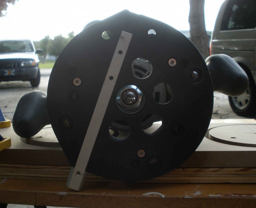

Too bad the router Buddy won't work as it has the more adjust-ability than the Jasper.
 This is from my build thread when I built the X-LS Encores. The circle cutting base I made is from a scrap of Masonite. It fits 2 different routers, and cuts circles within a few thousandths of an inch (.002"). Cost nothing :thumb:
Re: My X-LS Encore Build
« Reply #6 on: 23 Jul 2012, 07:15 pm »
I should probably show how to use my home made circle jig for those that don't already know. I think it's easy to get perfect sizing using this method as I did. I have never used a Jasper jig, but I can't imagine it has every hole spacing necessary for all speakers which would mean a fudge factor instead of precision. However, if I keep building speakers, and I foresee I will, I will probably have to try the Jasper.
Here is how I set the distance needed: I calculate the radius needed for the hole or counter bore from the plans, and measure from the far side of the router bit to the center of the hole needed. I use a caliper to get the exact measurement. I mark the location with a mechanical pencil (thin lead) and drill a 1/8" hole with a brad point drill. It's amazing (or I am lucky) how perfect a hole you can achieve with this method. Only one hole was a little small so I used a 9/64" bit to open the hole, and used the larger hole by pulling the router tightly against the pivot pin (1/8" drill bit) to the outside of the circle while cutting. Worked great!

« Reply #14 on: 23 Feb 2014, 04:11 pm »
First Amazon review states it doesn't fit a Bosch 1617. The router I own... Bummer.
Supposedly my Ridgid router wouldn't fit either but it does. Plus, you can drill holes in the base plate to fit any router if none of the existing holes match up.
