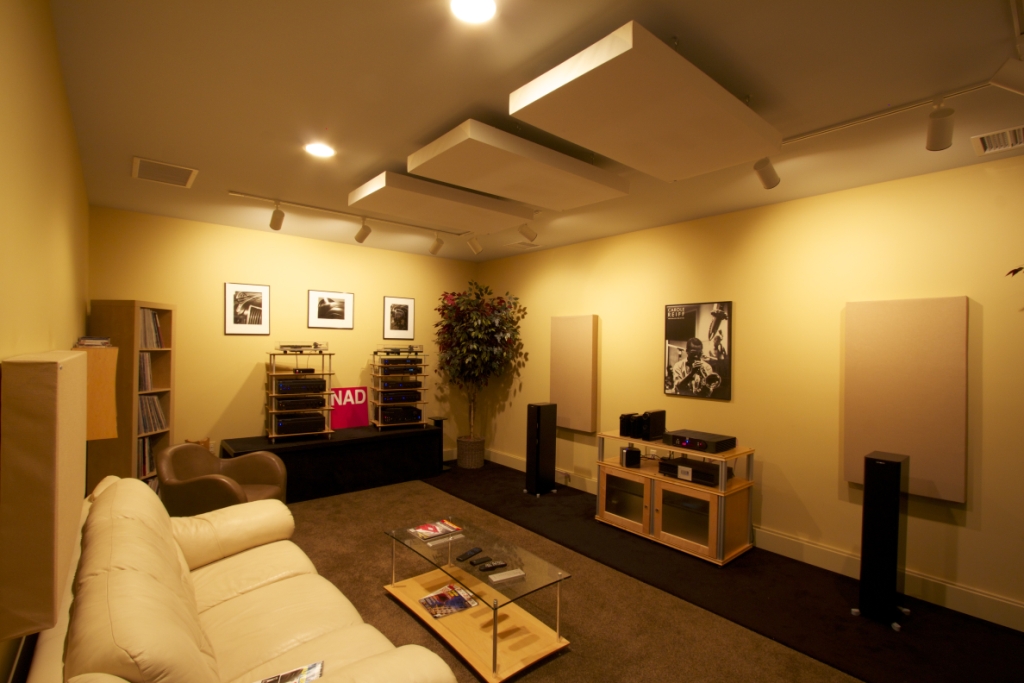

Hey guys,
Just got these pictures from a install we did at Overture Audio.
Pictures tell the story.  :thumb:

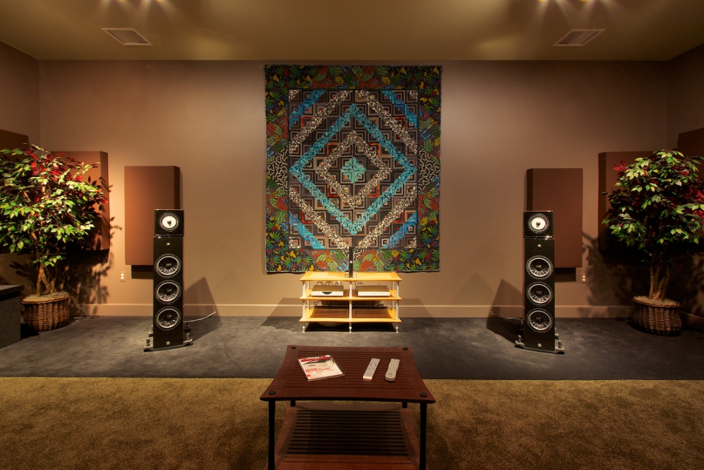

« Reply #2 on: 21 Feb 2014, 02:46 pm »
What effect did the big wall rug have?

Beautiful !
 What are the 3 traps or diffusors on the ceiling? I would love to have do the same to my ceiling. How the heck do you attach them?
 Are they first reflection point?

Beautiful !
 Bill
Looks like good old eye bolts screwed into the ceiling, is this better than flush to the drywall?

« Reply #5 on: 22 Feb 2014, 07:14 am »
I didn't notice the Cloud mounting brackets in your install, did the 242's have your scatter plates installed in the 242 and you mounted the cloud brackets to them?

« Reply #7 on: 24 Feb 2014, 02:02 pm »
Sorry the delay. My understanding is it is a hand woven rug that is not there for the acoustics. Only there to make the room look better.
As Glenn mentioned, this wasn't part of the acoustic plan. The beautiful quilt was handwoven by a long-time customer of theirs. Acoustically it probably does help a bit to reduce some flutter echo from higher up in the room (like you would expect from a curtain or quilt on the wall), but not much aside from that.
Beautiful !
Those are GIK 242 Acoustic Panels up there (in off-white). This room was actually completed a few months ago, before we released the Cloud Mounting Brackets. They're attached as Greg suggested - toggle-eyes in the ceiling to the eyehooks in the back of the panels. Hanging them with an airgap gives better performance at lower frequencies. Our panels already have a built-in airgap but an additional few inches is not such a bad thing! Plus visually it looks nice as well. The Cloud Mounting Brackets we now sell space the panels about 4" off the ceiling, too.

I don't get it. Not one corner trap and facing the long wall :scratch:

« Reply #11 on: 12 Mar 2014, 12:08 pm »
No corner traps were the first thing I noticed too. How do they manage the bass freqs?

« Reply #12 on: 14 Apr 2014, 04:56 am »
The array of QRDs behind the trio of seats.....aren't they a little too close to the listening position to be effective?  I had neglected to mount QRDs on my rear wall because just about all the information I came across indicated that my listening position, at four feet from the rear wall, was too close to be in a zone of effective diffusion.
- Michael
It is close, but the QRD is finless so you can get a bit closer to them. It scatters a bit wider then one with fins.
They just did not want them in the corners. Plenty of other trapping on walls though to help.  They also had to face things the way they did. Basically we helped with what ever we could but they had certain things they wanted.

« Reply #16 on: 7 May 2014, 02:29 pm »
Most of the room have the speakers placed on the long wall ( rooms 1&2 show all walls best).  Can you give the approximate dimensions?
