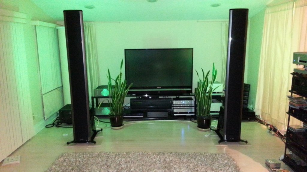

Just set up the new flagship speaker from BG Corp. the FS880.
They replaced my prototype LA 800's in walls that we modded to dipole.
They consist of a total of: 12 NE0 10's mids, 32 NEO 3's tweeters and (8) 8inch drivers powered by (2) 1200 watt BG amps.
They are the most dynamic, transparent speaker I have ever listened to.
They are so smooth and detailed that 100db feels like 75db.
This lack of strain and effortlessness at high levels is due to many factors
1. active Pass Labs Xover with Gold Point Attenuators
2. Pass XA60.5's on the tweeters
3. Luxman M600A's monos on the Midrange Neo 10's
4. 2400 watts from BG Amps on the woofers
We also use (4) BG 12sb subs along with (2) 6ft tall 15 inch driver transmission line subs

Ok to set the record straight the speakers are modular construction
The woofer sections have their own separate enclosure and are physically apart from the panels they connect to one another via Allen screws 4inch long but again do not share the same cabinet
The panel is made from aircraft aluminum and coated to prevent any vibration from the woofer cabinets
Yes both methods either active and passive have their pros and cons
However after 5 years of R&D with my 2 engineers and consulting with Igor Levitsky engineer at BG we have determined that even the best passive components are not at least in this speaker design optimal as the speakers retain more transparency and volume effortlessness when active Xover is employed
Although these speakers are 93db efficient they like current and like to be played loud at realistic levels
By using active Xover the amps have 4x the power for each planar section and since the amps are pure class A on the panels they always stay in class A and do not have to exhaust their rated power to slide into class AB
The woofers utilized are strategically located in the corners and across the room for bass control and room node elimination
The 4 bg subs are only 4inches in diameter and house 12 of them per woofer for a total of 48 inches of woofer per module
The benefit of this design is that they are lightening fast and are the only woofers aside from a planar woofer that keep up and are as fast as the planers
The transmission line woofers are only set at below 30hz and are set very low to prevent any bloat and blend very well
You are nervier drawn to their attention  unless you are playing Crystal Method
If you look in the left corner of the pix I attached you can see one of the transmission subs-to the right one of the BG sub modules
