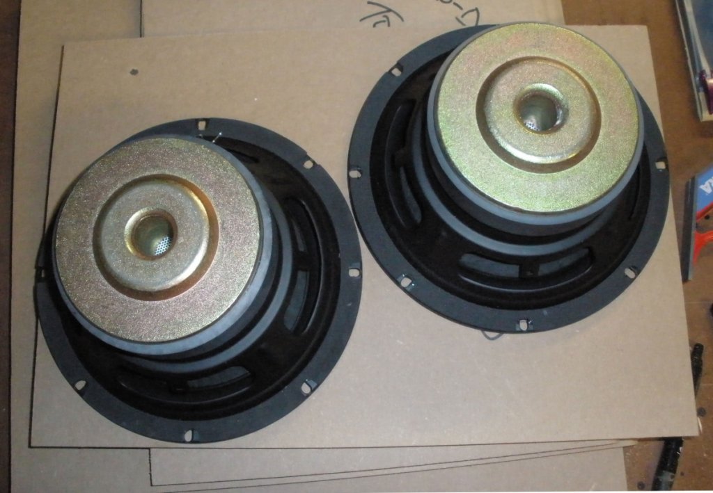

Danny, you suggested building two boxes side-by-side sharing a common side wall. When I laid this out the two drivers are out to the edges of the enclosure and very close together. Here is a picture. Will this work or is it going to cause a problem?
The woofers do get pretty close to the outer wall so when you make the inner wall a common one then you do have to stagger them a bit. Should just fit though.
