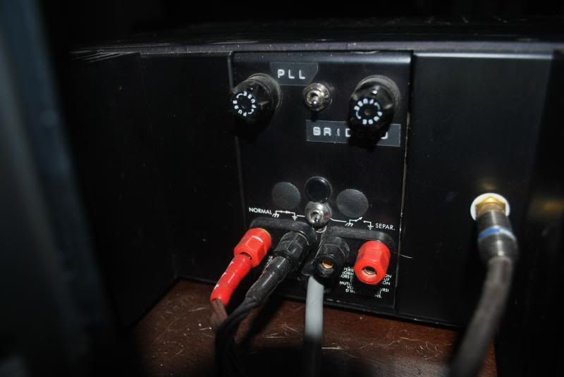

    Just wondering if I had these hooked up correctly.  Going to an 8 ohm main speaker.   These are the old 6B's from the first batch, both single digit serial numbers and differ a little from the later ones.  I heard only 50 were made but I have another with a sn of 265.  Was also unsure of switch on the bottom.
Hi
Looks like you are using the Parallel mode - for 8 ohms use the Series mode.  use the 2 REDS and move the black cable to the RED connector -  leave the top switch where it is.
