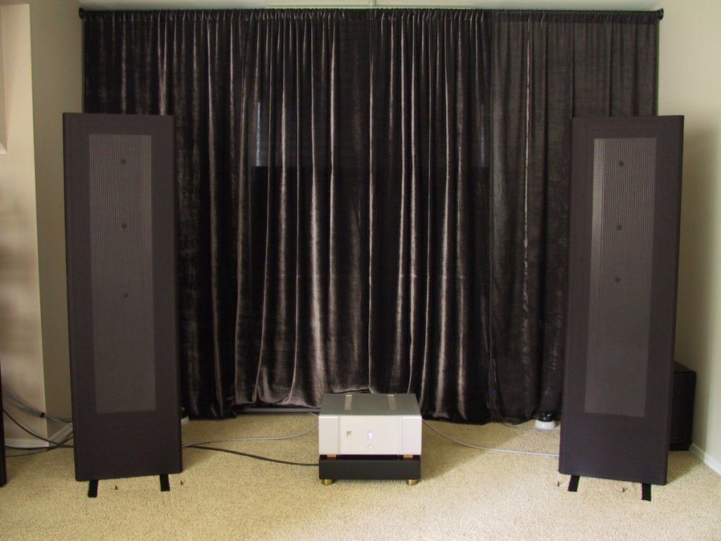

Hear Clifford Brown
Posts: 604
Re: Magnepan 1.7s in this room
Reply #13 on:
31 Jan 2014, 09:51 pm »
They sound VERY good just sitting where the other speakers were. So far have only used the Ayre amp, just connected the speaker cables and started playing music, which means the Vandersteen subs are also in the mix. Blend seamlessly just like before, but the bass is stronger. Part of that could be the Ayre amp is being driven harder than with my other speakers (10 ohm impedance, 92 dB vs 4 ohm 86 dB for the Magnepans), although the subs have their own built in amps, so I'm not sure about that. The bass is very clean and tight as before. There are 4 Real Traps in the room.
I have the tweeters on the inside and will try them on the outside, as well as experiment with speaker position (so easy to move!) to see if the soundstage changes. Will try them w/o the subs.
The Magnepans seem to really come to life when turned up a bit. My Coincidents sound really alive and detailed at low volumes as well as loud. I may miss that but I think the Magnepans play louder without sounding stressed at all, which I also like.
Just heard a piano solo in a great Lucky Thompson recording, Soul's Night Out. I thought, that piano sounds more real than I've heard before
Reply #17 on:
4 Feb 2014, 01:48 pm »
Congrats on getting the new 1.7s. If you like the sound now, just wait. You will find that the bass really hasn't emerged to its fullest yet. The mylar has to relax a little and after that the bass will fill out and reach a little deeper. I found that break in happened over a few months. Pushing the volume will help stretch things out quicker. As to placement the room looks great. I kept mine tweeters in, but tried both approaches as well. I prefered the more focused center soundstage that having the tweeters in provides. Enjoy.
Hear Clifford Brown
Posts: 604
Reply #18 on:
11 Feb 2014, 03:40 pm »
Just an update - these speakers are amazing considering their cost!
They had about six months of use before I got them so might be well broken in. The bass is so good without the subs that they are not really needed, although they add a nice foundation with some music. A couple days after initial setup I realized I didn't change the sensitivity setting on the Vandersteen 2Wq subs from 92 dB (my Coincident Speakers) to 85 dB (the 1.7s). That made a huge difference. Bass with subs is perfect now.
I moved the the 1.7s sans subs temporarily to our family room/kitchen which is a much larger space. They sound maybe even better in his space, wish they could stay here. More distance to the side walls, a little over 3 feet, a 9 foot ceiling, and 18 feet behind the seating.
