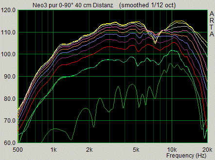

All Neo3s come with a back cup that has to be removed for dipole use. The PDR-models have a
bit more wide sound spread but seem to have an issue at least in dipole use with a peak in the treble band around 7 kHz.

This is the 0°-90° response of the "nude" dipole Neo3 PDR in 10° steps:
Never ever try to equalise that 7 kHz dip to "flat" in the on-axis response. I'm tempted to make it even deeper  :roll:. The response will even out at the listening distance, because the dip disappears off-axis.
