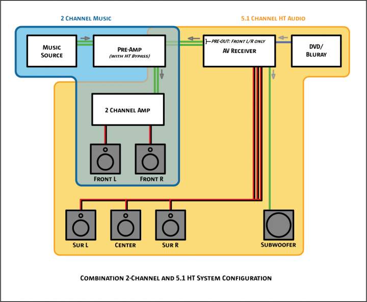

low.pfile
Re: Just got my first tube gear, got a question.
« Reply #15 on: 17 Jan 2014, 05:03 am »
...STILL NOT CLEAR
Which Tube Pre-amp are you using that has 6.1 inputs?  are you using the tube pream for TV/MOVIES, etc or just 2-channel music?
I have had a tube preamp with a second amp connected to my Denon 4306 AVR ( only for 2 channel music - see diagram here ), but your description of your cabling between the source BR/DVR to preamp AND preamp to AVR is not clear,sounds like a lot of cables.

I have had a tube preamp with a second amp connected to my Denon 4306 AVR ( only for 2 channel music - see diagram here , but your description of your cabling between the source BR/DVR to preamp AND preamp to AVR is not clear,sounds like a lot of cables.
It is the avr 6.1 input not the tube preamp. The tube is in between the source analogue out and the analogues in (6.1 inputs ) of the avr.
