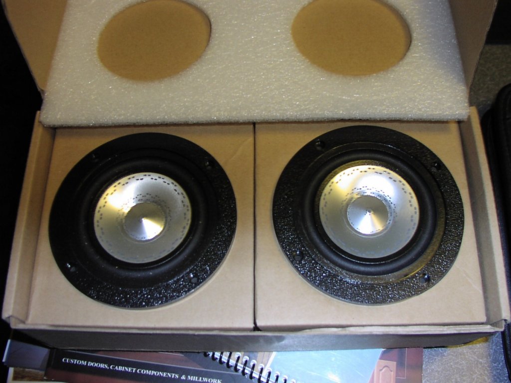

Some time ago I bought 2 pairs of Mark Audio CHR-70s from a poster here. This was around the time Danny was helping me with Desktop speaker and I was kinda taken with full rangers at the time.  They sat and sat...and sat.  The idea's been cooking in the back of my mind for some time. Some of you know I sorta like contemporary looking stuff and the metal drivers just begged for this look...well, in my mind at least.

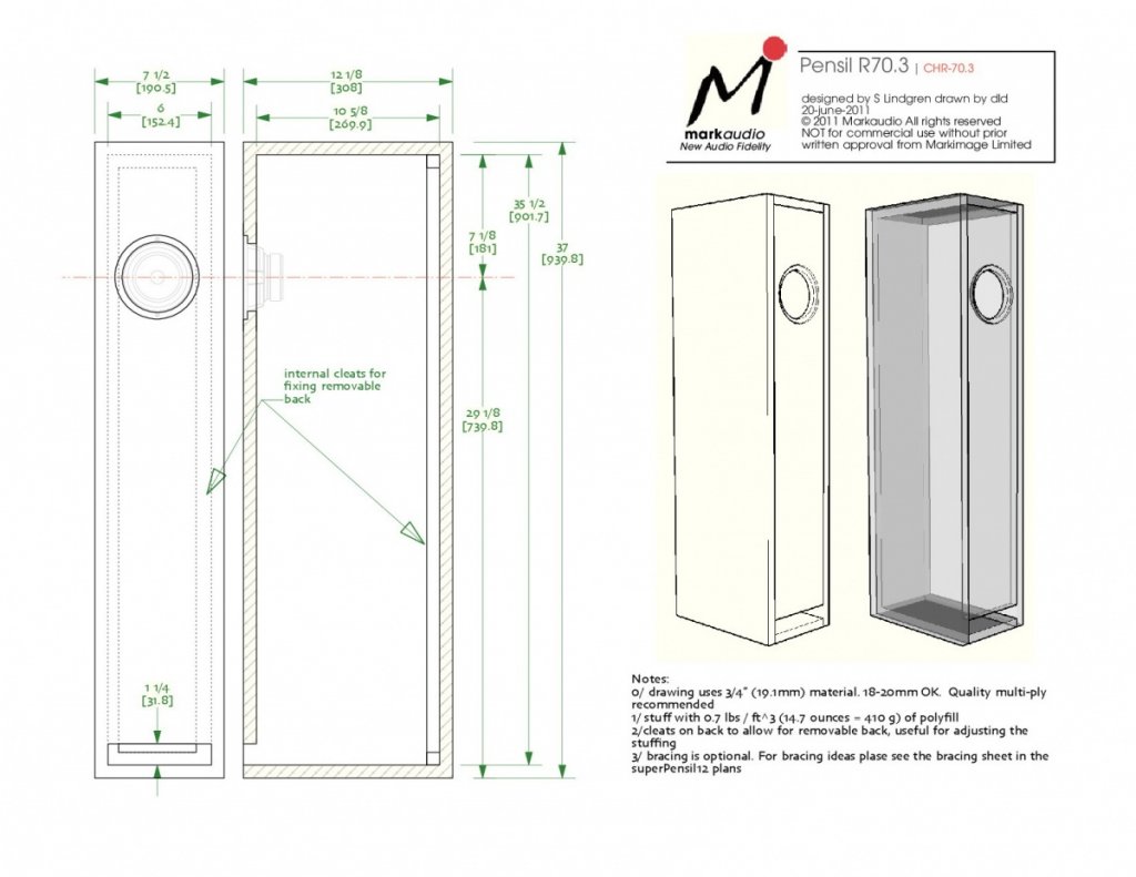

I took this design,

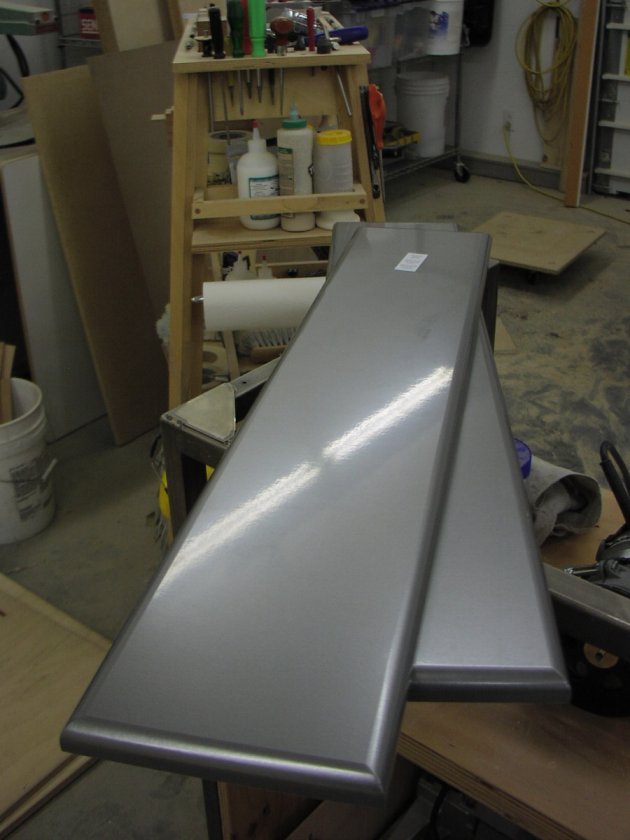

but wanted to give it a different look, so ordered some panels from a supplier for fronts and backs

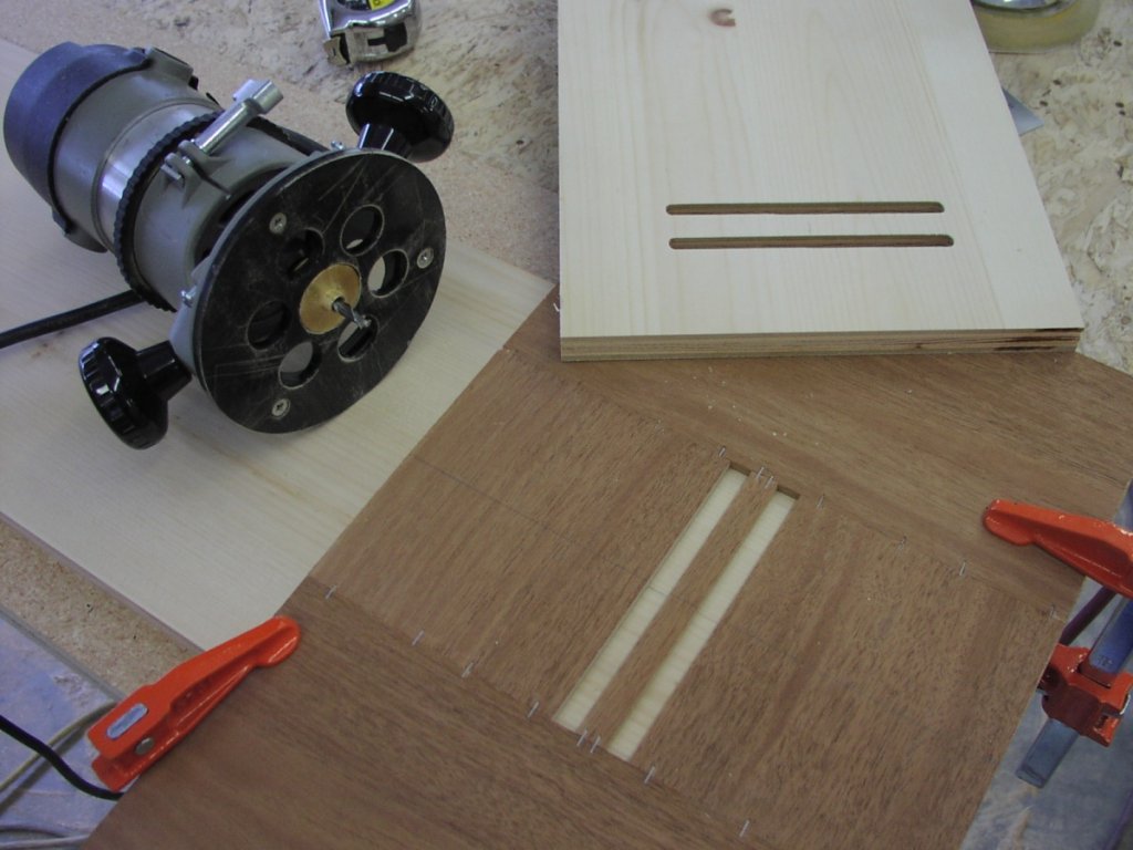

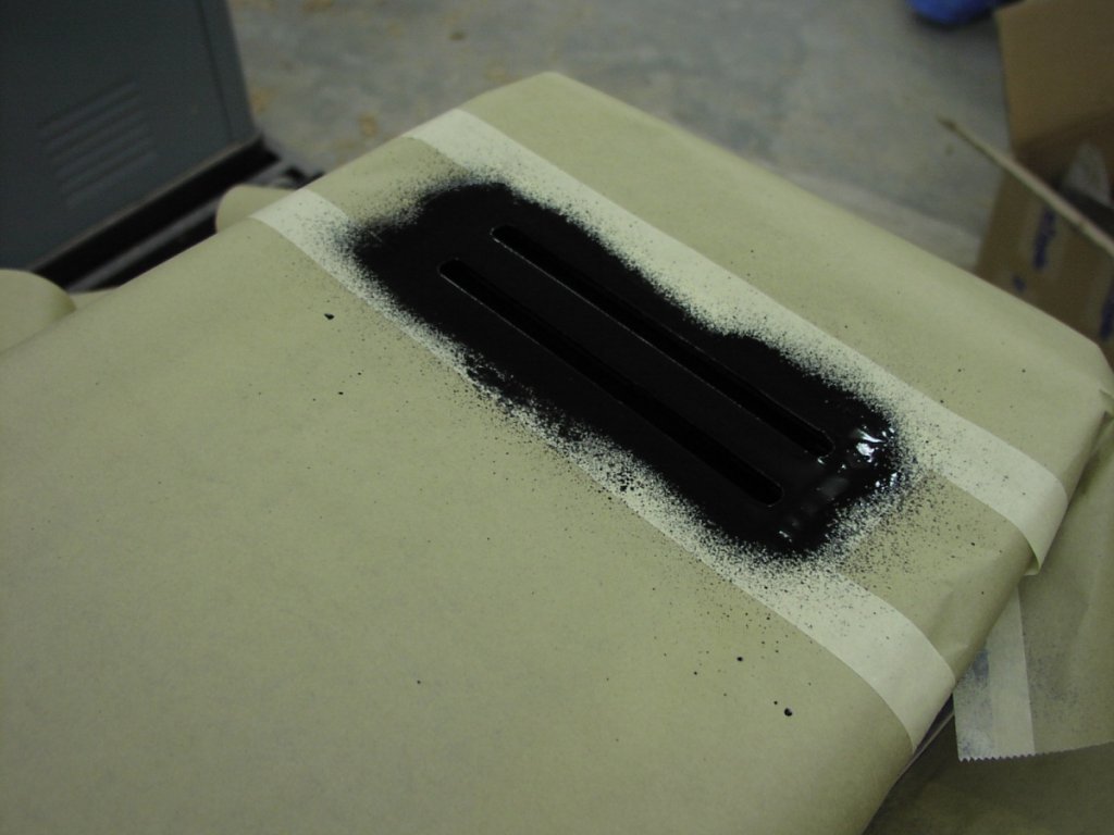

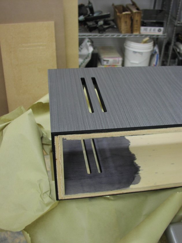

and changed the port to side slots, (probably violating some cardinal rule of speaker design)

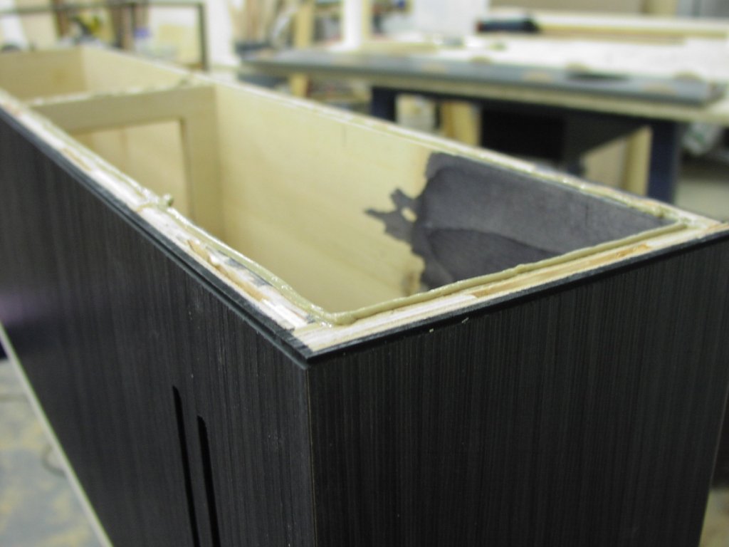

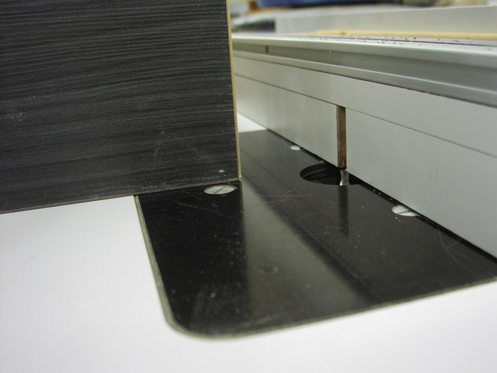

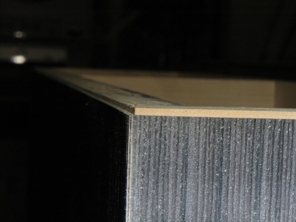

With prefinished material, the mating of parts is a little different. I machined a "furniture joint" to conceal the joint between box and front/rear.

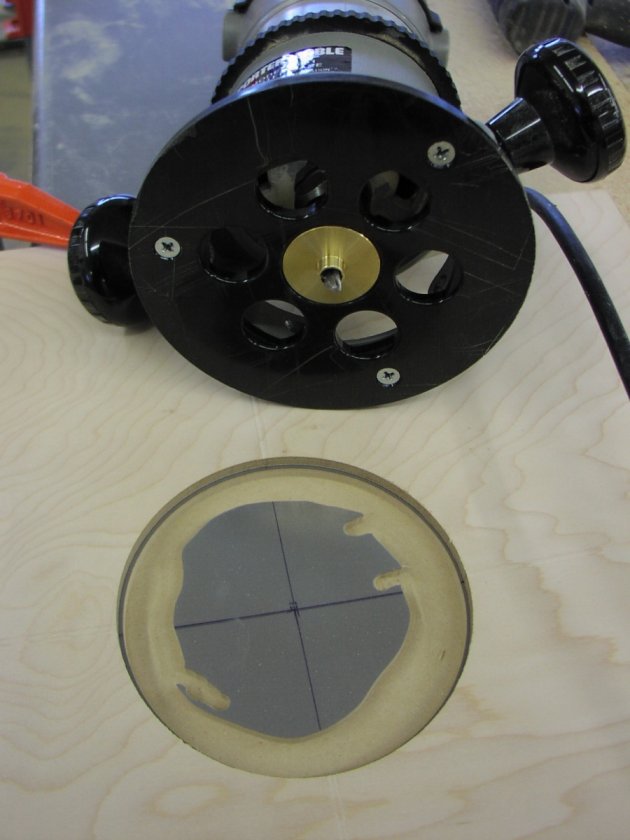

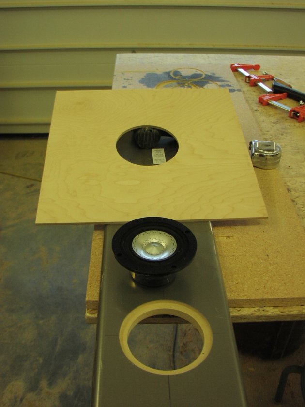

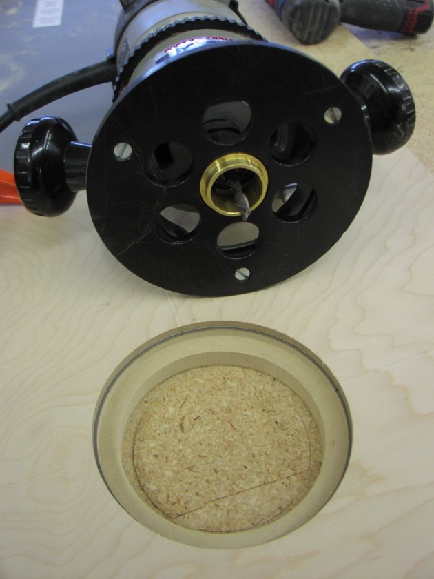

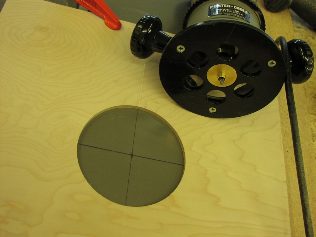

 I prefer to cut driver rabbets and thru-holes with templates, here's a sequence of shots on how that's done. I make the template with Jasper Jig

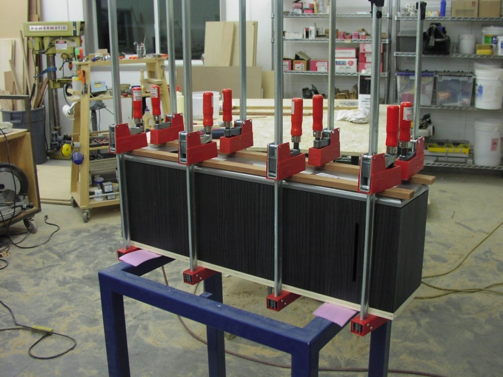

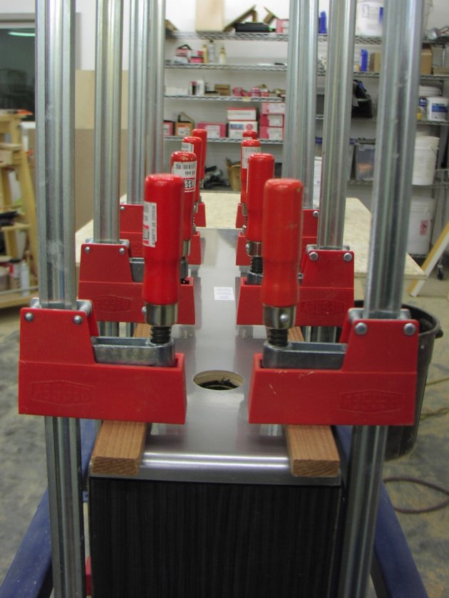

Assembly is a little different too. Can't have glue oozing all over, so  a small bead of PL Premium and just enough glue in biscuit slots to get the job done

As far as the slits go for a port opening, I don't know for sure on speaker cabinets but when I am tuning a wooden flute I can cut the end off until I get the note I want or I can drill holes or cut slots at the proper spot on the sound chamber as long as the volume of the slots equals the diameter of the bore.
The same principle may apply to speaker cabinets

That's what I theorized, Mike, for better or worse. 1 1/4" x 6" = 5/16" x 6" x 4. I think I know that this might cause port chuffing, but can't imagine that much air volume and velocity coming from this driver, but that's seat-of-pants engineering and not really based in science....perfect for the audio world :icon_twisted:

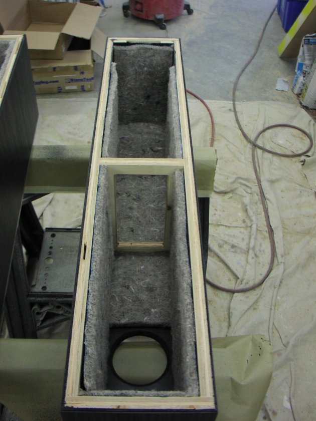

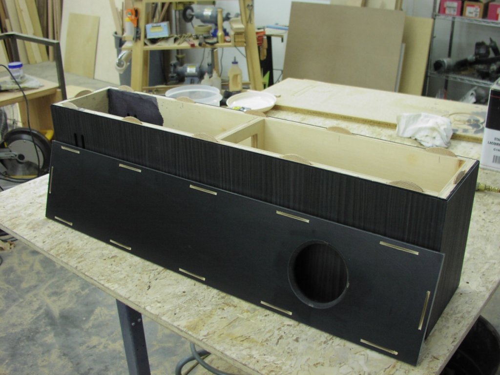

Moving right along...

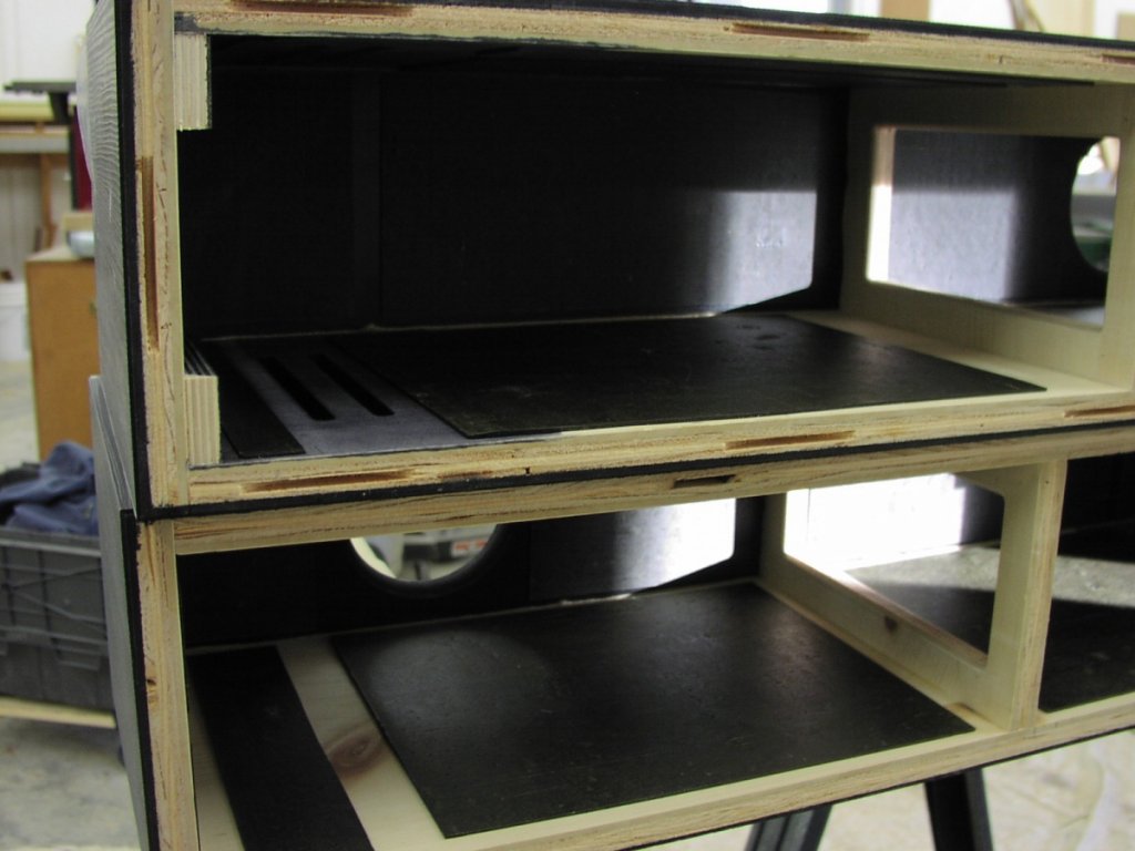

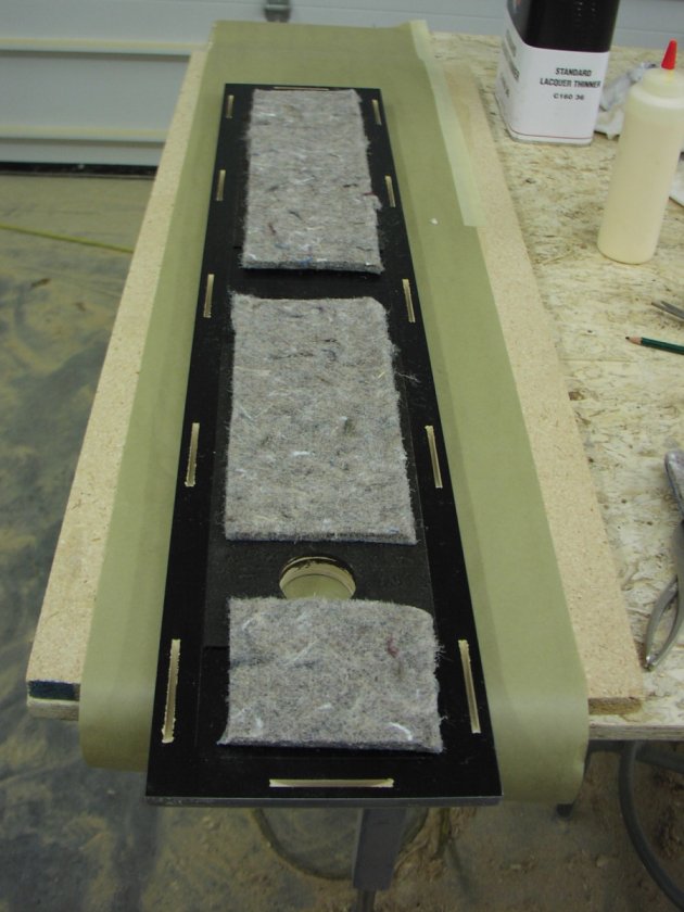

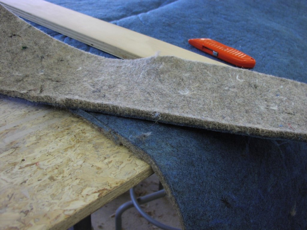

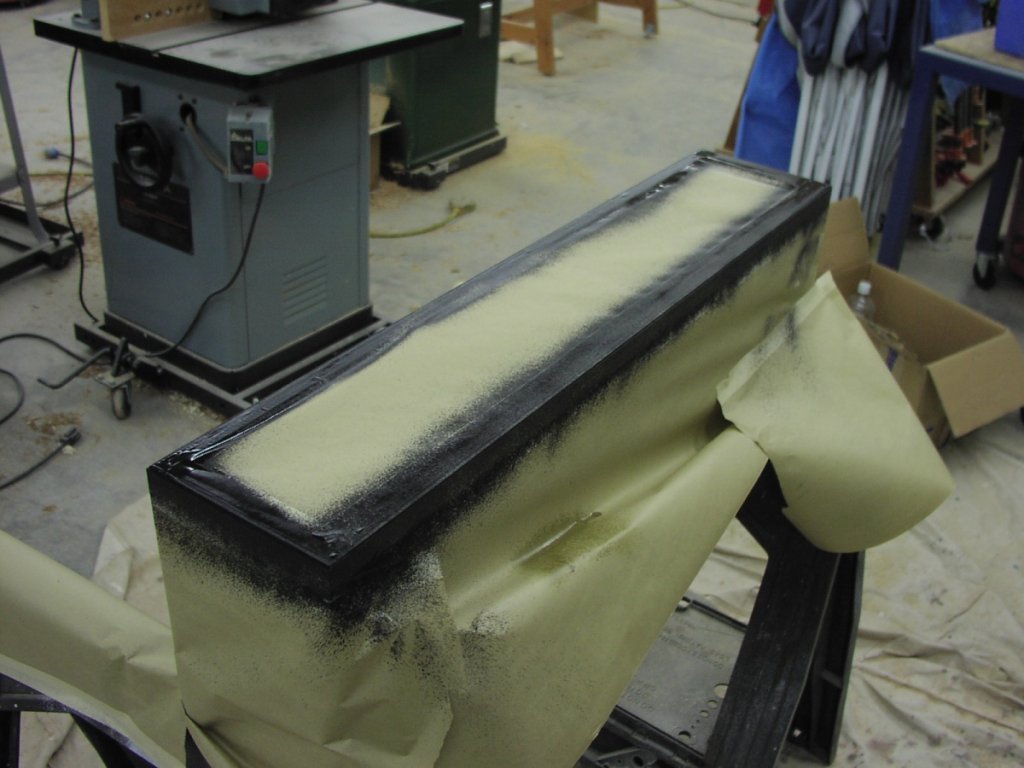

 I'm damping panels with this, gone up in price some since I last  used it, $38 for 6 sq. ft.
And lining with this, I'll use some Dacron fill too, but stuff through driver hole, since there's no removable back like plan suggests...probably shooting my foot
Gluing back just like front
A new speaker is born...well, almost. Cool thing about prefinished materials is once it's assembled, it's close to being completed!

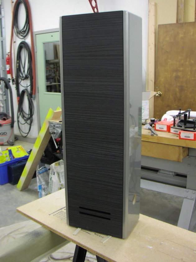

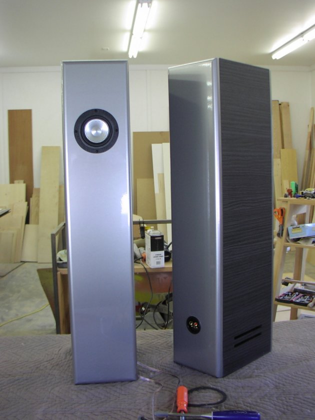

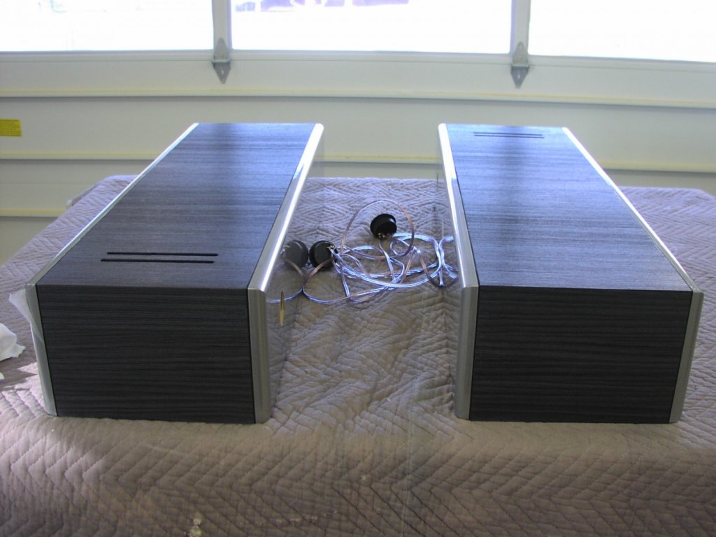

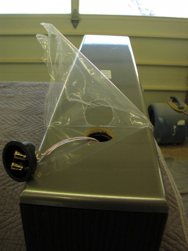

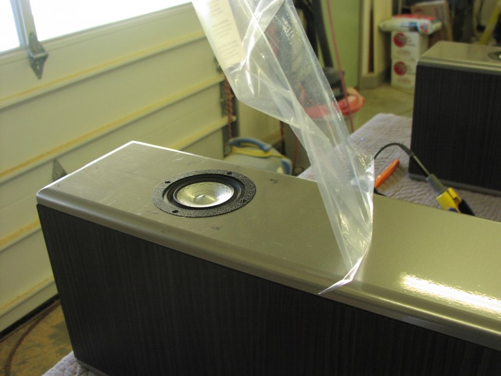

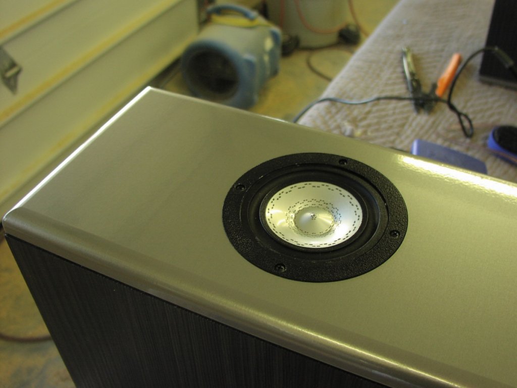

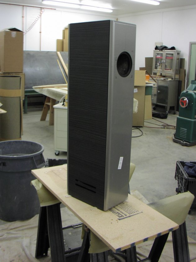

Houston, we have liftoff...

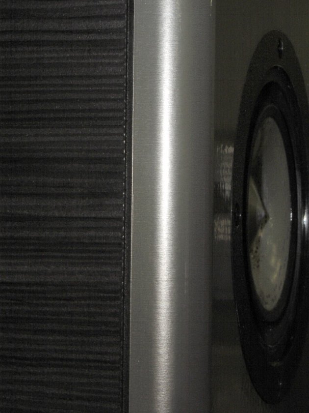

This shot sorta highlights the 3d grain in the sides, hard to see in photos
The front and back come with a protective "peel coat", fun to pull off for the first time!
And then
playing to the messy shop, someone should clean it up  :oops:
I tried to get a shot of the grain in the metal look RTF, hard to capture

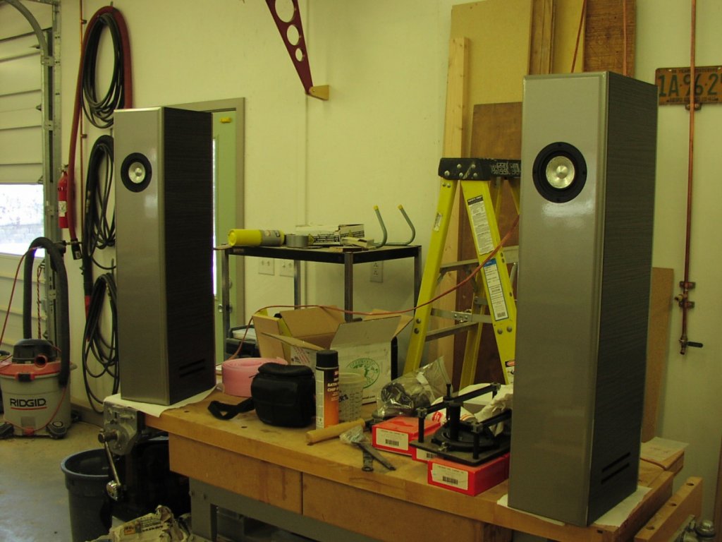

Larry PMed me about felt. Here's what and where for anyone else interested
http://www.ebay.com/itm/MULTIPLE-SIZES-Blue-Max-40-Ounce-Recycled-Felt-1-2-Thick-Area-RUG-PAD-/130869723608?pt=US_Tools_and_Accessories&var=&hash=item1e787181d8
With only 30 min. playing time, I imagine they've got some breaking in to do, but here are some initial impressions.
Two things strike me as noteworthy about the single drivers I've heard. First is coherence, there is something unique sounding about having all frequencies emanating from a single point. Second, bass. I'm truly surprised by the bass these and the desktop speakers I made produce. It's not tactile like a bigger driver, but it's certainly noticeable...heard but not felt, I guess would be a good way to describe. My slot ports seem to work fine, but like any other port, I don't think you'd want them against a side wall.
Within their limitations, they are pretty amazing. Won't rock the house or rumble the movie soundtrack, but for a smaller music system, I could easily live with 'em.
Looking forward to Danny's entry into this market.

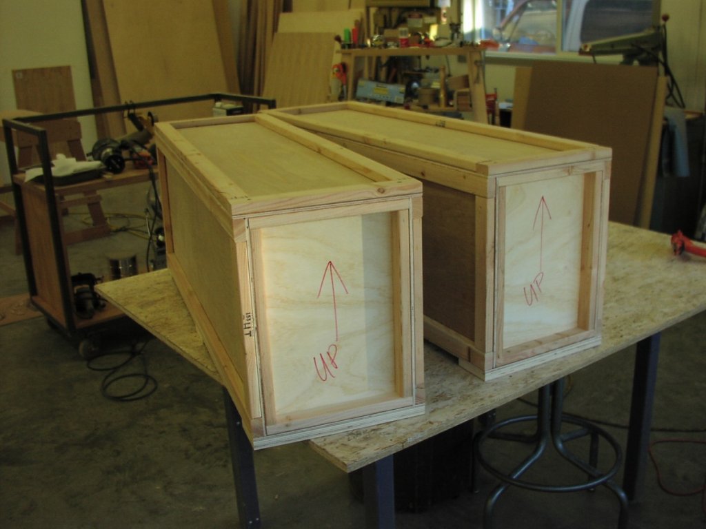

  • Posts: 1966
  • Hmmmm
Re: ***Full Range Driver Build***
« Reply #18 on: 5 Jan 2014, 07:04 am »

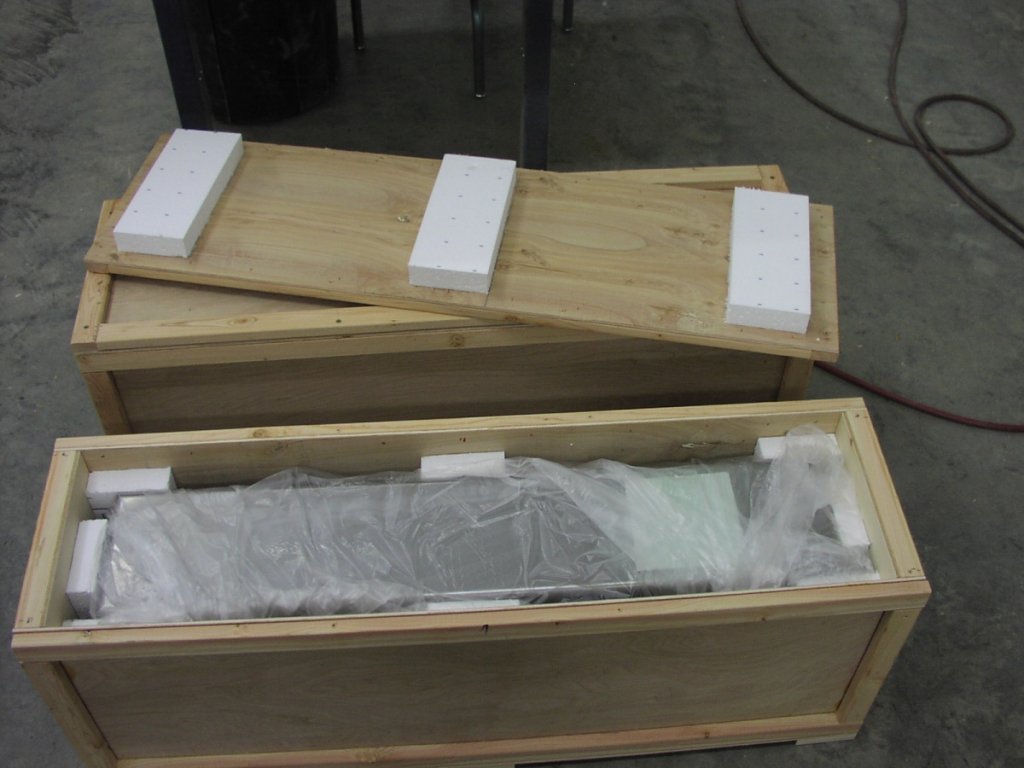

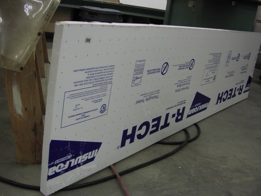

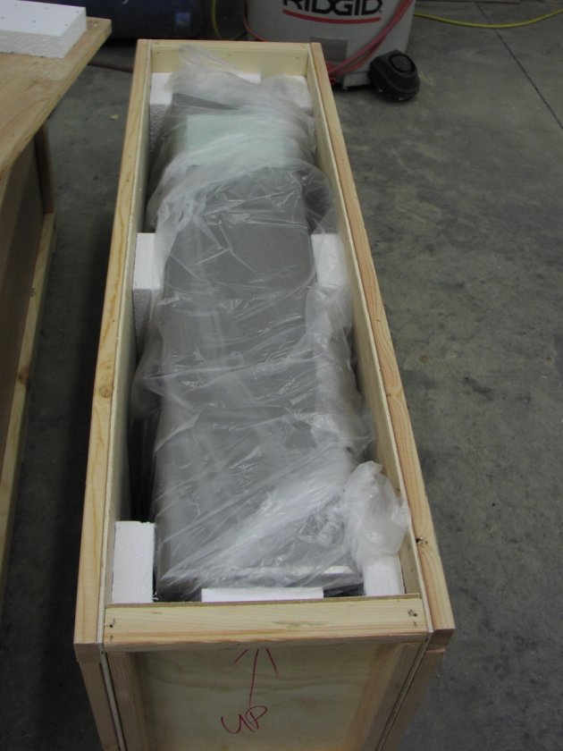

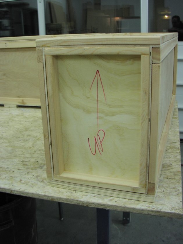

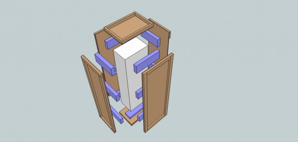

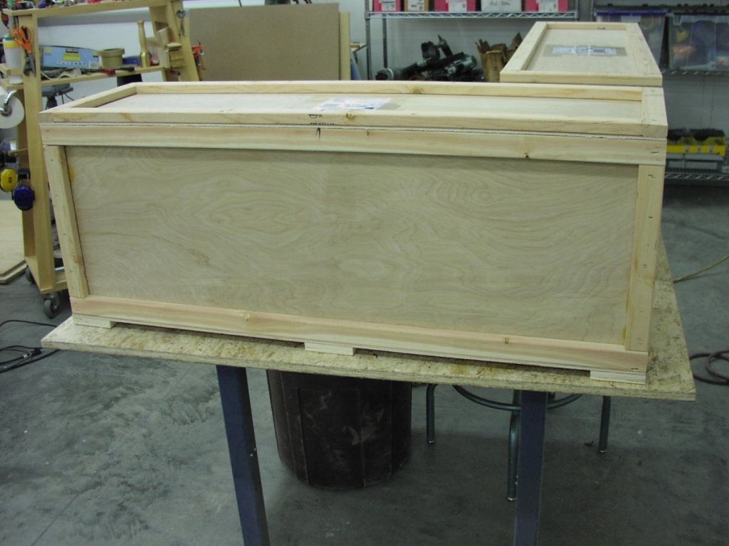

I'm a fan of crates, shipped some pretty big and heavy stuff around the country with no damage...knock on wood. (there's a pun there somewhere). It sometimes helps that I have scraps in the shop already, but in this case I bought a dozen 1x2 furring strips and  a couple of sheets of 1/4" plywood underlayment. It's light and plenty strong. I had the foam. For bigger stuff I scale up to thicker ply and foam.
Essentially, I'm building a box that provides air space all around speaker and then hot gluing foam strips in this space. In this case I used 1 1/2" foam so my crate interior size was 3" larger that speaker in all dimensions. I like to put the frame on the outside like an exoskeleton so it gives hand holds to the shipping monkeys, in this case UPS. My thinking is that it will get dropped less if there's something to grab onto. Although I think it could survive a fair amount of abuse, I rather not test more than necessary. I glue and staple the all but the removable lid which is screwed on. At the very least, these will see two or three rounds of shipping.
I think the photos and graphics will do a better job explaining than more words...
First off, one needs a good helper for artistic inspiration and fitting purposes
EPS insulating foam is easy to come by and has worked well in the past
And the crate itself, speaker is wrapped in dry cleaning bag, a roll of which I somehow ended up with :?
Here's an exploded view so I could exercise my limited Sketchup skills
