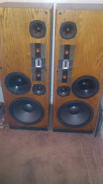

Here they are set up in my room. Still tweaking them. Bass and mids are great. Highs seem to be missing some "air" compa
red to my Magnepan 3.7s and Janszen Za 2.1s.
 NC400s running Mids and tweeter. Rowland 525s on bass.

Here they are set up in my room. Still tweaking them. Bass and mids are great. Highs seem to be missing some "air" compared to my Magnepan 3.7s and Janszen Za 2.1s.
That would be unusual (missing air) in the RM/x.
Remember the FST (free swinging tweeter) needs to be adjusted (angled) toward your listening position.
Missing or reticent highs might be a symptom of that angle being less than perfect.
I believe you will need an allen wrench to loosen the FST and make the adjustment and then tighten again.

I have tried adjusting them and even turned the tweeter level up all the way. They just seem recessed in volume. You can place your ear directly against them with the speakers say 90db and barely hear them.
Hmmmm.. .that is unusual and not normal.  One of the best qualities of VMPS is the HF and transparency over most other designs.
Take a flashlight and examine each tweeter to see it it is broken or torn.

Someone posted about replacing failed FST on the RM-X, but I can not remember if he did or did not say the FST was a weak spot or ?
They are crossed 2nd order @ 8k Hz or possibly higher, presumably a normal application for that driver.
I can not even remember what is the active woofer complement for the X.  Refresh my memory.
With the ribbon tweeter using an 8K high pass, it's basically used as a super tweeter.  So, depending on one's age and hearing ability, low perceived output could be due to the owners hearing acuity, instead of a fault in the speakers.  Sorry, it happens to the best of us!    :wink:
Other than that, maybe hit the level pots with some Deoxit.  It couldn't hurt.
The RM/X used a woven carbon fiber 10" front woofer, and I believe a woven 12" side woofer, tuned with the bottom mounted 12" passive radiator.  The front 10 was a midbass, and the 12 was a megawoofer.
http://pointillistic.com/vmps-audio/RMX.htm

AFAIK Brian never employed a 90dB+ woofer.  The MW is probably 88 dB max (talking actual numbers, which are used almost never).  The mid bass would barely if at all increase the overall sensitivity, and ditto the PR.  That makes actual overall sensitivity between 89-90 dB.
So the 96 dB FST (if it really is 96, which I doubt) is padded down 6-7 dB to match the bass section.  Meaning the FST would appear to be highly under stressed in that application, and at extremely low risk of abuse.
Stimpy gives good advice.  The FST is most definitely not crossed as a tweeter.  At that time Brian used no LP filter on the mids.  Unless Brian updated the xo with a LP filter on the mids (Roy might know about this), the FST pole is actually more like 11k Hz, higher than anything except harmonics and percussion instruments.  With some program there is little to no content through the FST.

I would wonder more about the midrange panels than the tweeter; as has been mentioned, the primary and often 1st harmonic of much of what we consider "high frequencies" are below 8 kHz

The highest fundamental violin tone is C8, the highest piano key, which is 4186.00 Hz, or about one octave <8k Hz.  The FST on the original X crossed no lower than 8k; if it was update with a LP pole on the mids, possibly around 6k.

The FST tweeter of the RM/x crossed at 6.9K.

Titaniumheads,
IIRC the best access to the L-pads is to remove the side firing 12", which is more difficult that one might think without seeing them.  Upon request via PM I'll forward my phone.
If there is any question about performance, the first thing I'd do is buy a can of Caig DeOxit Gold 5% or 10%, get to the L-pads internally, and spray the you know what out of the resistor winding while sweeping the knob back and forth like your life depends on it.  The L-pads are about 20 years old now.

Thanks so much for all the feedback. I tried two things that Roy suggested that really helped. Before, I had the Ncores on the mids and tweeter and the Rowland on the Bass. I had tried the Ncores on the bass prior and they were not as effective as the Rowland. Also one time the left Ncore shut down for a few seconds while playing a loud passage. Roy said he suspected a problem with my Ncore amps and had me jumper them and just use the Rowlands for both. He also had me move the selectors back and forth a bunch of times as he had never done that prior. That helped immensely. In my frustration Prior I ripped off the foam from the tweeters thinking that was the culprit even though Roy told me not to. Now I need to find where to get some of that. Mcmasters does not have it in their catalog. I will get deoxit as suggested and remove the sub for access. I will have to say that of all the money I have spent on audio these make me feel like I have climbed thru the Rabbit hole and found an exit.
