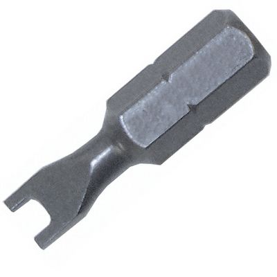

Boy, that's a weird one.
Do you think you can get enough of a grip on it with something like this?
My husband tried that first, broke one of the teeth off, that's when I started gettin' antsy.
