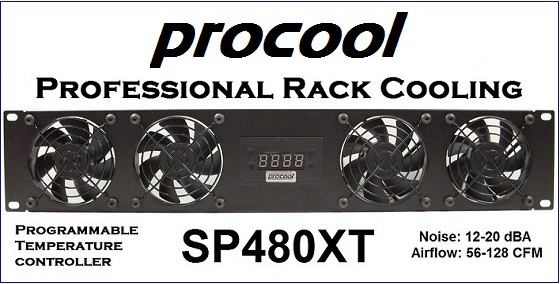

I have two of these and they are DEAD SILENT,also they have  lots of different styles on their site :thumb:.
