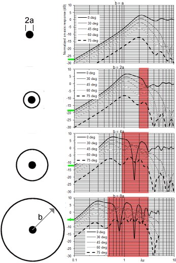

The 6,5" driver should have a cone diameter of ca. 5". This leads to a value of 873 Hz for "ka=1" in the diagrams below, assembled from http://www.linkwitzlab.com/models.htm#A3:
On the left you see a black driver cone of radius "a" in a round baffle of radius (from top to bottom): b=a, b=2a, b=4a, b=8a.
ka=1 is 873 Hz, ka=10 is 8,73 kHz and ka=0,1 is 87,3 Hz.
Your 6,5" driver in a 70 cm wide baffle would be b=5,6a. So you have to interpolate.
What do we see:
From ka=3 upward the driver response starts to beam (because of the cone size). Baffle width has increasingly less influence, because the beam touches the baffle edges less and less.
Down from ka=3 we have a red zone, which widens with the increasing baffle width. The red zone marks an area, where controlled directivity gets widely lost and the dipole radiates in wiggling lobes to changing directions. This can't be helpful for a precise soundstage.
Below the red zone we see the regular dipole radiation pattern again.
You should try to keep the red zone for your 6,5" driver as small as possible. You can't avoid it completely without changing to a 4-way system. But it would be helpful  if you reduce the baffle width around that driver to b=2a at least.
Note the green marks on the left vertical scale of each diagram. They show the SPL loss of the baffle at 87,3 Hz compared to the driver in an infinite baffle. As you see, a wide baffle is much more efficient than a small one. You need to take that into consideration, because your driver needs to reach down to the crossover with the alpha15.
