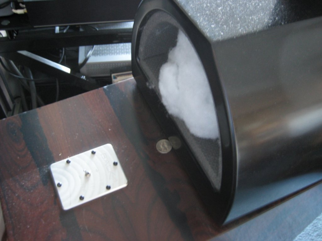

The SoundScapes have two backs.  One closes in the midrange chamber to make the sound similar to normal closed box speakers.  The other back is an open grill that makes the SoundScape a hybrid open baffle speaker.  The open grill adds a lot of ambient bloom to the sound of music.  One can add stuffing in the midrange chamber to adjust the amount of ambiance appropriate to the music.   Most music is recorded in fairly dead rooms so using a minimal amount of stuffing seems to work best for me.  That is about ½ full of loose poly-fil.  That amount adds a good deal of beautiful bloom to the music which is very exciting.   One issue that I have is that some music is recorded on a stage that already has a good deal of ambiance recorded.  Extra ambiance is often noticeable on a lot of orchestral music.  This is due to being recorded on a lively concert stage.  With these recordings and large amounts of SoundScape ambiance the sound is thin and muddled.   Of course, I can add stuffing to to the midrange chamber to make the orchestral music sound fantastic, but that makes most other music not sound as exciting or lively.  I could use the closed in back for orchestral music, but that would make the orchestral music sound less live too.
There is a solution that works for me.  The SS10s and SS12s have the midrange chamber sitting on top of the woofer cabinet.  I put a quarter flat on the woofer cabinet so that I can rest the solid back on the midrange chamber about an inch away from the midrange chamber and lean the top of the back on that chamber.  The quarter acts as a spacer to create triangular openings at the sides of the solid back.   This allows much less ambiance to be created.  This seems about right for orchestral music recorded on a live stage.  The following pictures show the setup.
Quarter on Bass Module
Solid Back leaning on Midrange Chamber
Solid Back on Midrange Chamber
Most people who listen to TV and Movies with SoundScapes prefer to use the closed back.  I am one of them.  Voices don’t need much, or any, ambiance.  Music in movies probably won’t sound as great as they could with an open back, but that doesn’t seem to be much of an issue.  I have a problem in that after listening to TV and then play music, I sometimes forget to remove the back.  Often, I will listen to music for thirty minutes before I start to get bored and realize that I didn’t open up the back.  I have found that if I listen to TV with the solid back leaning then I have a compromise that is easier to live with.  The leaning back adds enough ambiance to not get so bored with music when I forget to open the back.  The leaning back adds so little ambiance that it doesn’t negatively affect TV or movies much either.  FWIW, this means that I never need to completely close the back.

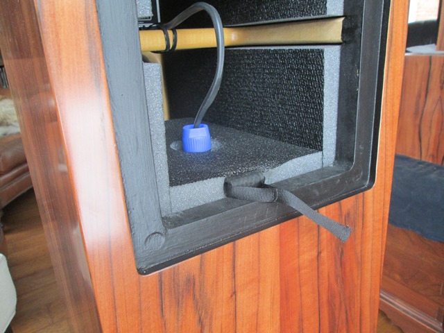

I have not seen many photos of the back of SS10 or SS12. Thanks for the photos and for your experiences.
I do not ever remember seeing a photo of the back of a SS8?  Would someone please post photos of the back of the SS8?

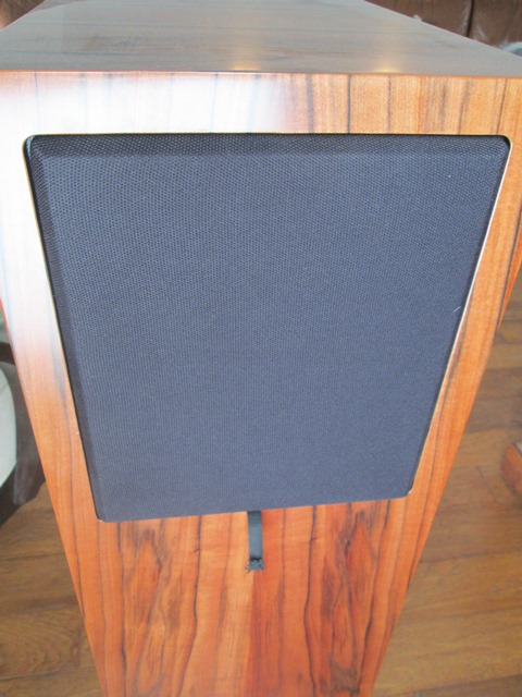

Vulcan- I took a couple of pictures of the back of my SS8's a while back while playing with options to help me remove the backs  more easily.  I thought I had one of the entire back while open, but I think you get the idea of what we've got...
