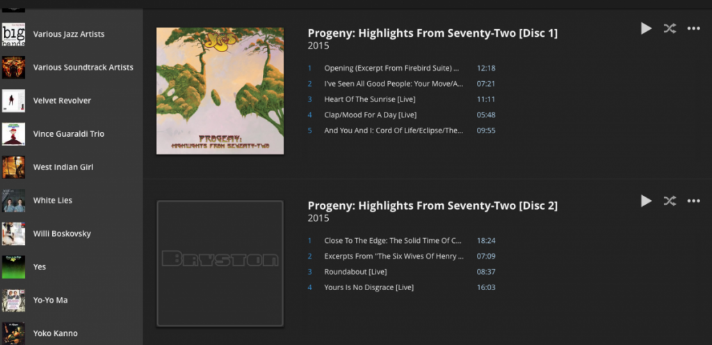

Updated to latest beta build:
S2.29 2016-08-24
Build: Manic Moose
MPD: 0.19.12 NEWS
Kernel: 3.16-0.bpo.2-486
COPYRIGHT BRYSTON LTD. 2010
You are very close to the goal line on the album art issues.
I wiped all converted images and rebuilt the Bryston DB. I have album art as thumb nails and artists view (i.e. 250 and 44 versions), with one exception: any album that is split into multiple discs does not show the thumb image for the follow-on discs (e.g. AlbumName [Disc 2] or AlbumName [Disc 3]).
See attached screenshot for clarification:

« Reply #1903 on: 25 Aug 2016, 06:52 pm »
UPDATE: I've noticed that adding new music and updating normally recreates a lot of missing album art. If I SSH into the device and manually remove all of the converted thumbnails, then reset the Bryston DB and let it rebuild... I then see all of the artwork (except for the issue noted above).

« Reply #1904 on: 26 Aug 2016, 02:14 pm »
Hey Ken,
Do you have each cd in its own folder or both cds in one folder?

« Reply #1905 on: 27 Aug 2016, 03:02 pm »
I'd have to guess he has them in the same folder. I have a number of multi-disc albums and when I rip them I do so to separate folders and the art is always picked up appropriately for each disc. How would the above screenshot be possible if the 2 albums were in the same folder? Wouldn't there just be a single item in Artist view or would you just simply modify the tag data to be different between the 2 discs so that they retain the slightly different album names as seen above?

Hey Ken,
One folder. Only the ALBUM tag differs. Recall that I did this specifically to work around the issue of the DISCNUMBER and DISCTOTAL tags being ignored when queuing albums for playback in Default View (i.e. intermixing discs by TRACK).

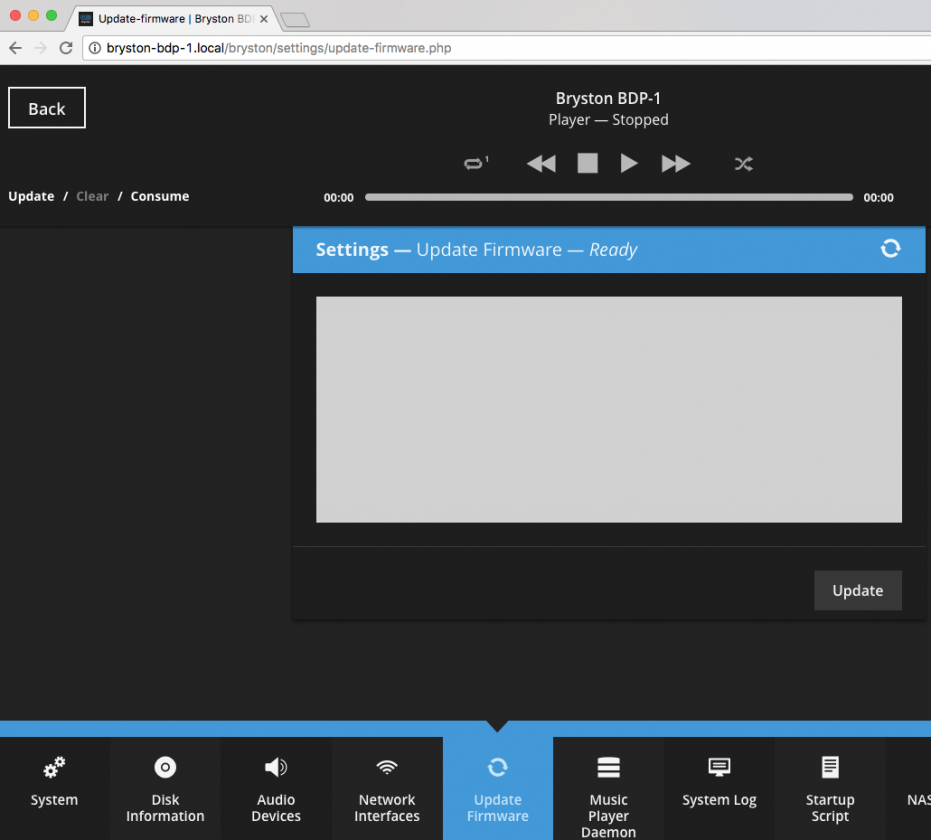

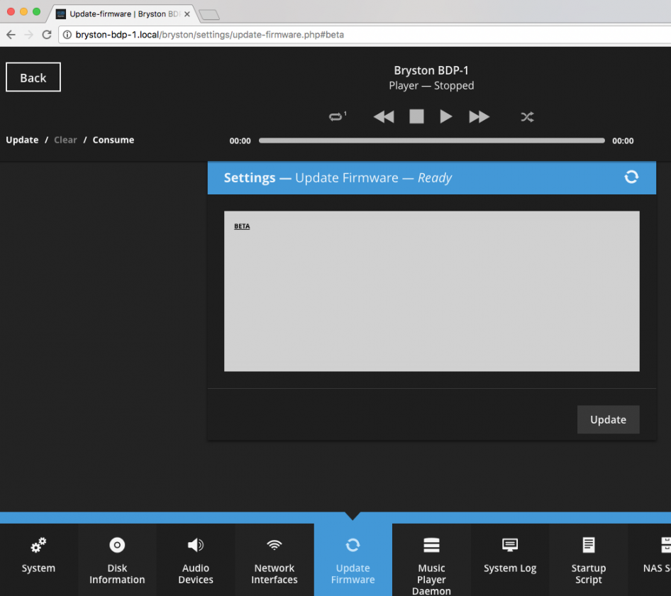

Latest BETA firmware... cannot update or run Factory Reset to a stable, released version.
S2.29 2016-09-20
Build: Manic Moose
MPD: 0.19.12 NEWS
See the attached images: regardless of whether I run a normal Update Firmware or add the #beta to the end of the URL, I get nothing in the display area. I've rebooted a few times and even ran the System / Reset To Factory function, but I am still on the BETA release and cannot see any update information.
Also, the main page always displays "BDP has no internet connection" even though the network connection to the BDP is fine (I can access the Web UI and play music via MPD) and I have a working Internet connection.

Chris,
I've placed the BDP-1 into service mode (Service ID: 38) if you want to look at it.
Thanks.

Re: Manic Moose (S2) - BDP's third major firmware release
« Reply #1912 on: 23 Sep 2016, 03:04 pm »
same here on beta S2.29 2016-09-15
probably a Bryston server outage again?
Hi
Nope - something to do with DropBox
james

« Reply #1915 on: 23 Sep 2016, 07:02 pm »
BDP-1, BDP-1USB and BDP-2 should be able to check for firmware again

« Reply #1917 on: 24 Sep 2016, 02:14 pm »
BDP-Pi's should be back online as well now, any one who installed the S2.27 2016-09-20 testing build may need to be into contact with us to get the firmware to update past it.
Cheers
Chris
