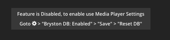

I don't use the Album View and have the Bryston DB disabled, have been playing with it before though. Gave up in trying the album art in MM, and concentrated on playing the music...
Above experience learned that sometimes it is not clear you have to both enable the DB, click Save and then Reset DB.
Did you do both, and in that order?
Maybe first disable, Save, reset Db. Than enable again. To have a clean DB and be sure.
Personally, i always prefer an extra reboot in between as an extra  cleanup.
Marius
I know there is the Reset or is it rebuild db option in the Settings menu (the gear icon) when in Media Player mode if that's what you are thinking of. That one definitely had no affect. There might be a more potent option somewhere else though.
Marius
hmm, I never did disable and re-enable but was saving after I reset. I can give that a try and see if MPD will re-create the 2 image files, I'll just have to remember to remove the 2 I manually created.

« Reply #1539 on: 31 Jan 2016, 03:06 pm »
Well that didn't work to well. I'm now getting a message saying Bryston DB crash detected. I initialed a reboot via MPD but that didn't seem to have any affect :(
