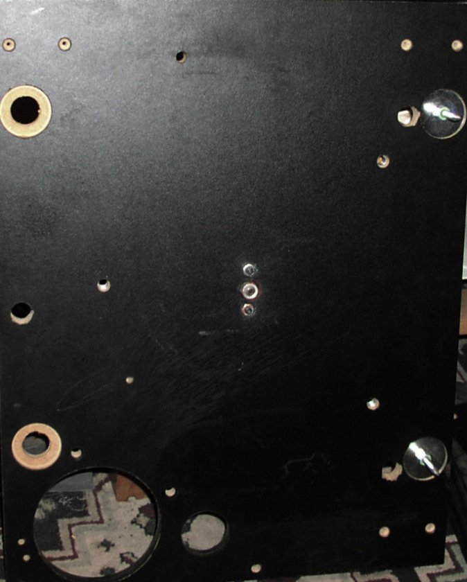

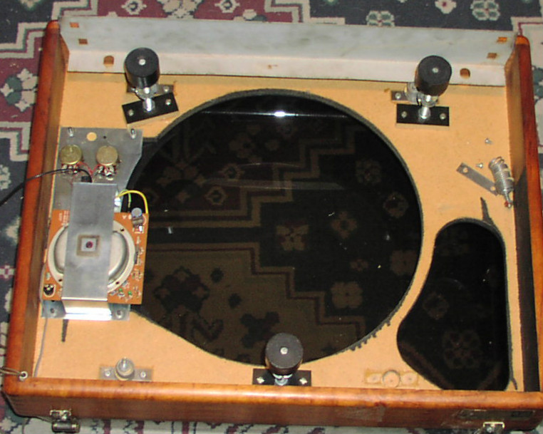

« Reply #38 on: 16 Oct 2013, 01:41 am »
I caught same kind of flu or bug so I haven't made a lot of progress.  I took some photos - thought you might be interested in seeing how this is built and what I'm doing.
At the top of the picture you see a steel brace I cut to use as a corner brace between the top and the front panel.  It's sitting on the springs so it's not seated.  There's also one for the back.
In the lower right corner near the armboard, you can see how the springs are seated.
The center of the spring recess is marked and I'm going to drill right through the top piece to mount 4 - 1/4" brass bolts.  Those washers are approximately where they will be.  Those bolts go through the subchassis where the springs were bolted down.
I had already replaced lost screws securing the motor cover with brass.  I think it should look okay.
Abandoning the suspension allows some redesign.  Those heavy blocks at the corners (lead I think) will be used on either side of the bearing support housing. The housing is secured to the subchassis with three small bolts.  The blocks will keep it steady and hopefully absorb any vibration.
I also have additional steel braces for the chassis.  Two other things I was thinking of doing were to use a couple of corner braces between the sides and the subchassis for further support.  Everything bolts through the subchassis so it can be disassembled.  The other thing is to redesign the armboard and mount.  I'm quite sure I can improve it, but maybe I'll get it back together first and get it going.

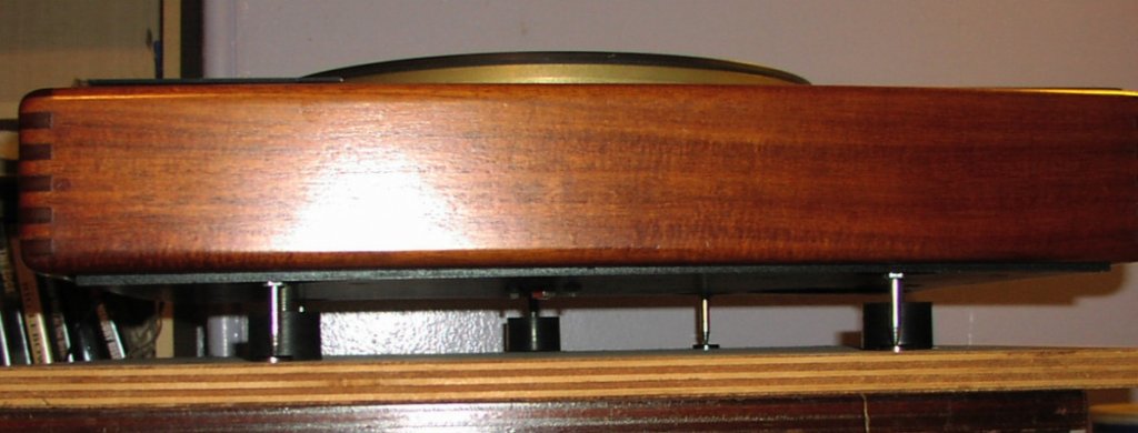

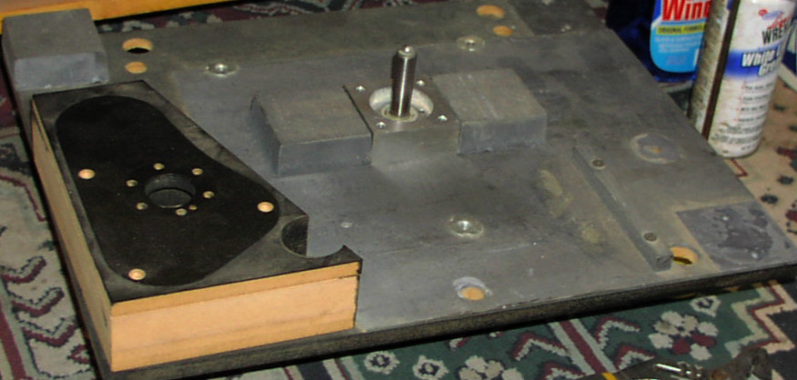

I was figuring out the logistics of all the mods when it occurred to me, there might not be a need to bolt the plinth on the subchassis.  If I install a spike where the spring seats were I could have the subchassis stand on its own and the motor/plinth separated from the rest.  Sort of like having a motor separate from the table.
This is the bottom of the chassis:
The rubber feet are on the plinth - spikes on the subchassis:
Eureka!! it actually works.  Still have a lot of work to do.  I need more weight on the plinth, but all the bracing and reinforcing the top panel doesn't seem quite as urgent.  I'm thinking of getting some sorbothane washers for the motor mounts.  Don Grbluen kindly sent me some stripped video tape to make a belt and that will take a little doing, but the latest approach will allow some adjustment of the distance between the pulley and platter.  I was wondering how I would get the belt installed.  The tape won't stretch like a rubber belt.
