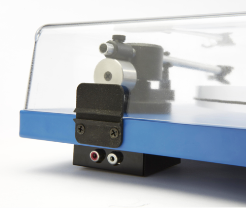

Hi all Audio Circle members.
I've seen it several times on different makes of turntables
but don't know why they do it that way.
There must be a reason and/or and advantage.
The counter weight is not monted directly on the arm's tube,
but via a decoupling.
What's the reason/advantage.
Waiting for a logical reason.

My guess it is a cost saving measure.  It is cheaper to mount the weight and slide the tone arm back and forth for balance and VTF vs. machining/threading a counterweight on the arm itself.  At least that is what I gather from the pic.

Did anyone think about the physics involved here?
Lowering the center of gravity for the tonearm system probably increases its stability. The stylus and cartidge are actually underneath the main shaft of the tonearm, so if you didn't put the counterweight at the same level or about the same level, the slanted axis of balance would make the arm more unstable. Someone, balance your tonearm and see if the line between the tip of the stylus and the center of the counterweight shaft is level.

Yes, that is the correct reason!

Bingo! Actually the arm is a uni-pivot, so it needs all the help it can get. AR-XA(XB) tonearms had a dropped counterweight as well, and as others have said, lowers the center of gravity of the arm and aligns the cartridge mass with the tonearm mass.
