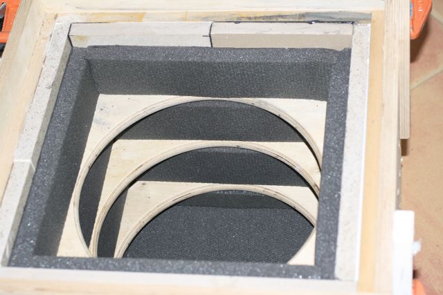

Needed a sub for my bedroom system and thought it would be a good project to try out ideas I've come across, mostly from this forum.

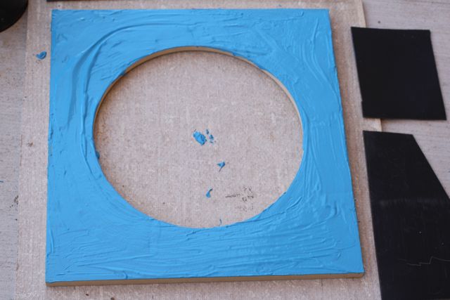

The design is a double layer box, inside box 3/4" lite weight MDF, outside box 3/4" Birch ply. The inside of the box is lined with a layer of 3/4" man made stone, used for counter tops, I used a poly adhesive that stays flexible, and a layer of No-Rez on top of that.

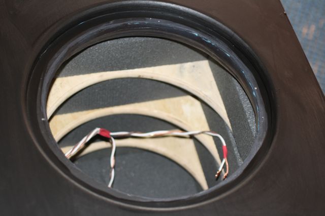

I used 3 front baffles with the middle baffle sandwiched between the other 2 with layers of damping materials in between. The outside edge of the inner baffle also has a layer of damning.
Thanks to Danny at GR for calculating box Vol for me.

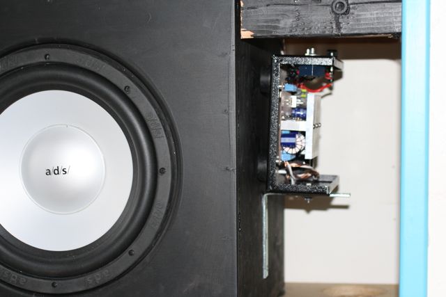

Driver
Stone Lining
With No-Rez
Front Baffle
Installed
