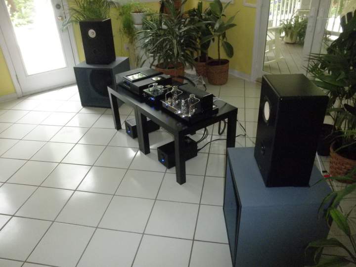

Yes, Poultrygeist, that's very similar to what I'm doing. In a nutshell:
Sources (Sony SACD and Well Tempered via a PS Audio Phonolink) and preamp (actually a Meier Corda Prehead) are around the corner in another room. They'll be connected to the Dayton amp(s) by a long interconnect run. The Dayton(s) will drive the Fried subs while their line-level outputs carry on to the Wright 2A3 amps driving the Omegas.
If these Dayton amps have any guts at all, they should easily handle the Frieds. If not, I do like the idea of lowering the cutoff to 40Hz. We'll see soon! Everything is in place awaiting the UPS driver. I've been listening for the past two hours and the tubes are nice and warm ... I should be able to get a Dayton inserted and playing within a minute of unpacking for a quick comparison. Stand by!

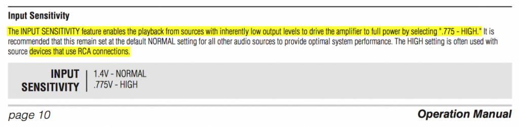

Maybe this helps. I pulled up the owners manual for the Crown amp Louis suggested, and it shows an option to increase the input sensitivity (to 0.775V) for sources with inherently low output.
